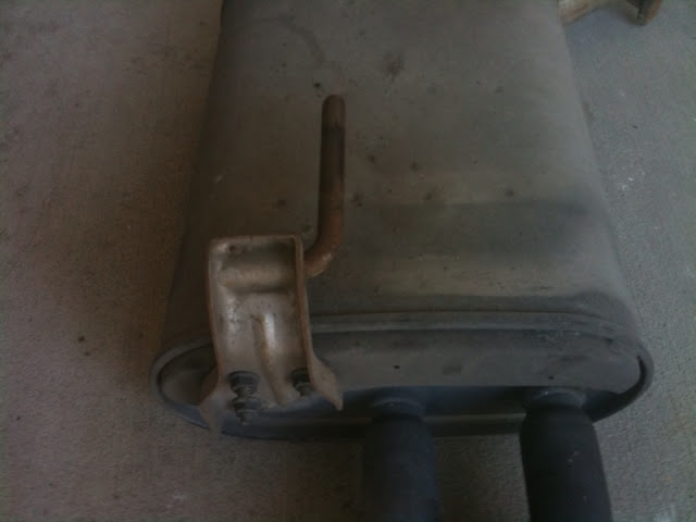

This is what you are missing:
As you can see, the brackets are bolted on to the muffler, totally different from the 06's you have.

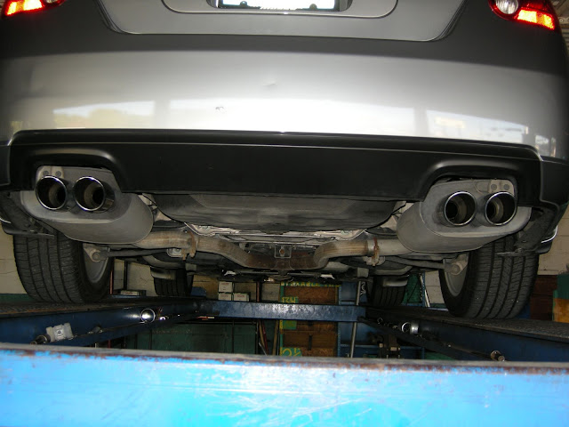

View from the rear before I installed my Magnaflows:
If you are gonna have a muffler shop to do install I'm sure they can fabricate a hangar for you.
