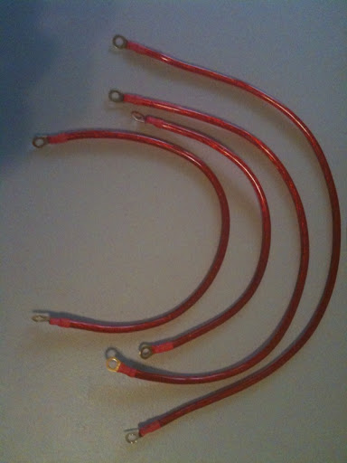

Monster Cable Grounding Kit....Because I Was Bored
They say idle hands are the devils playground, well this is the outcome.
Left over 4 gauge monster cable from my audio install, 4 gauge ring terminals with 3/8" eyelets, and shrink wrap insulation bought at Harbor Freight. Took the wire measurements from the Active Tuning website and Voila!!! Spent <$10 on supplies, FTMFW!!!

You will need at least 6.5ft. of cable: 15",26",20",and 12". Measurements are for 6th gens.
Installation instructions are here:

Hey Gollum, are any of them stretched tight at those lengths?
Would an extra inch or so on each be helpful for tucking?

I haven't installed em' yet and I hope each is long enough. I did cut the wires a bit longer than the stated lengths.

i think i used the same measurements years ago... i suggest making the one from the battery across the intake to the fender a bit longer... if your intake is still stock at least. My new battery's posts are a lil off and made it even tighter.

I have the F5; I'll lengthen it a little...

I used 4g JL Audio flex cable, found the ends in a hardware store and bought (used then returned) heat shrink at Harbor Freight.
I mounted 2 of them in different locations than the link above; the trans mount and the drivers strut plate.
Call me crazy but I can tell a few differences.
Just starting the car seemed completely different. Sound and feel.
I also noticed a somewhat different throttle feel. May have added some pep.
Overall, an easy DIY mod I would recommend. I'll report back after I drive a little more.
One thing I did do was dremmel the paint away on ALL the connections. Not just the one in the instructions.

I drove the car some more today.
The throttle response is noticeably different, the idle has changed and start up sounds amazing.
Im generally a "hard sell" kinda guy but Im really glad you made this thread.
Hurry up and install yours now.
