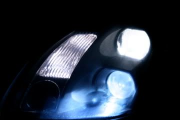

I've been wanting to get the switchback leds for the turnsignals in the headlight. Just wondering who has these in a 6.5 gen and if a resistor is needed?
I've searched a little and from what I understand it's a 6 ohm resistor that needs to be wired in.
If so, is it just wired in series with the 12 volt signal to the bulb?

If your just installing the switchbacks in the front then ya need a 50watt 6ohm resistor. It will be wired in parallel with the turn signal. One wire of the resistor on the hot leg of the turn signal and the other to ground.
The rule of thumb for resistors is a 6ohm resistor for each LED light. If your also putting LED's in the rear turn signal too then you use a 3ohm resistor.
The ezkoncepts LED light housings already have a 6ohm resistor built into them so if you had them you would use a 6ohm resistor for the front lights. Two 6ohm resistors in parallel =3ohms.
The resistors can be installed in the front or the rear of the car. Which ever you choose, mount them to something metal. They will get fairly warm and can melt the insulation off of wires. I have mine mounted and grounded in the trunk where the rear sonar control box would be on the drivers side. The wires to tie into are the green/black and green/yellow wires.

So if I'm understanding this right... if I am only doing LED switchbacks in the front, I need a 50 watt 6 ohm resistor.
4 questions:
Do I need a resistor for each bulb?
The resistor doesn't need to be wired at the bulb... it can be done in the rear?
Any chance I could get a diagram of how you did it?
Where did you get the resistors?

1 6 ohm resistor is needed per side.
Yes, you can mount them in the rear.
The turn signal wires needed are solid green and the black.
Use the wire taps supplied w/the resistors and you're good.

  1. One resistor for each side.
  2. The resistor can be connected into the turn signal circuit in the rear, front or anywhere in between.
  3. There is a diagram in the vled link above. Only difference in how they have it and how i done it is that i used a body instead of the ground in the harness.

Sorry but for the billionth time, resistor 101:
If you have:
LED blinkers only in the front then you need 2 6ohm resistors.
LED blinkers in front and LED BULBS in the rear blinkers you need 2 3ohm resistors.
LED front blinkers with LED tail lights you need 2 6ohm resistors.
Install them in the rear behind the tail light (not in the trunk) They hang down in the open area behind the bumper nicely and don't touch anything, because they do get hot. And they will be hidden and out of the way...
Here's the pic from the STICKY I did on LED lights in the tails:
http://www.vqpower.com/images/howto/...ails/LED-3.jpg
I bought mine from www.autolumination.com and have always been happy with their product, just upgraded to the 60 LED towers and they are awesome.
