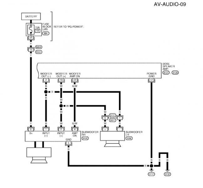

I have searched this forum and the net for specifics on how to install a Line out converter in my 04 Maxima. I bought one and have my whole dash and radio apart but there are so many freak'in wires back there, can't figure out which ones are the speaker wires..
I looked in the trunk, directly on the subs and saw which color they are but can't match them to in the dash behind the radio bezel.. WTF. And I can't believe I can't find it anywhere online. I have been searching for 2 hours

you want a Line Out Converter for a sub right?
you need an FSM. it shows the wire colors. It can be done in the rear off one of the subs in the deck. i dont remember which wire since i did this over 5 years ago. if i find it i'll post it up. check out the audio forum as well. more knowledge on this there.
Old Jun 27, 2010 | 09:41 PM
NismoMax80's Avatar
SuPeRmOd
Joined: May 2004
Posts: 6,378
hope this helps
wait, it can be done off the left or right sub. I tapped the sub for the remote on.
http://forums.maxima.org/audio-elect...-rca-wire.html
continue any questions there.
