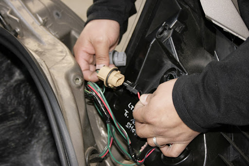

Conclusion:
Originally Posted by MAX2DAMAX
Problem: abnormal blinking or only one brake light works.
Solution:
Basically what is going on is that the connector on the oem bulb is thicker that the connector the led tail lights, so all you have to do (make sure the car is off and you don't have the any lights on) is close the pins on the stock connector and spread apart the pins on the lights, look at the pics.
And once again, make sure you have the black cable line up with the white black cable on the car!!!
BEFORE
AFTER (MAKE SURE THE LEADS DON'T STAY TOUCHING EACH OTHER AFTER YOU OPEN THEM)
Thanks to MAX2DAMAX for the thread..

Yup that picture is exactly what I did with mine.
