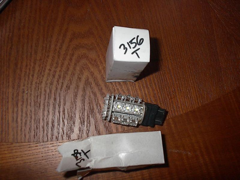

I used these 3156 Towers. Took them out years ago but they did work.
Attached Thumbnails LED cornering lights resistor needed?-im002232.jpg   LED cornering lights resistor needed?-im002233.jpg
