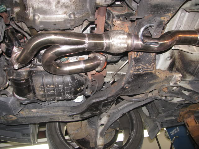

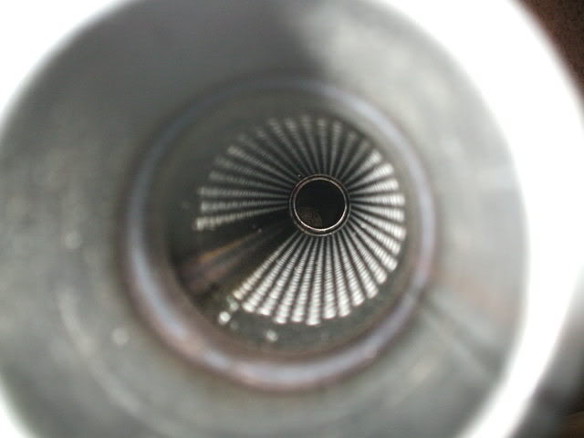

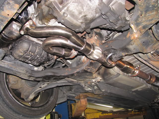

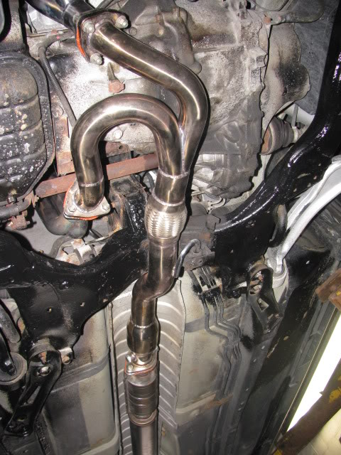

Looks good .

sounds nice. shoulda wrapped those headers while you where in there though...

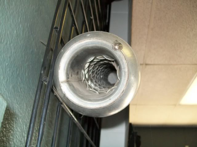

Is that 6in round res? I've been considering that one myself. The one I am using toned it down quite a bit, and made it just a tiny bit louder than what I would consider to be just right. Of course my res is more aggressive (I think) than the magnaflow.
Typical aftermarket resonator:
Inside of mine:

Originally Posted by Apollos2
Inside of mine:
Although louvered resonators reduce sound better than perforated core, they are more restrictive to air flow. Just saying...
...depends on your ultimate goal.
