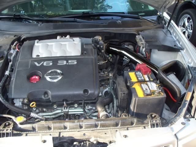

I gotta agree... with raz....... Either make your own CAI/SRI out of quality parts or buy a real one.
You have a really good idea going on man and it looks like you have the skill to fabricate things well, BUT... imo your using something that I don't think is going to work very well.
First off, you can't show it off, because when you tell people your using gutter/dryer hose for your CAI. No one with a true appreciation for cars is going to praise you for that. you may get a few laughs.
second, Intake stuff needs to be smooth if your trying to gain performance out of it compared to a stock setup. with all those ribs, you are going to generate a lot of turbulence in that hose. The air flow is going to be choppy and inconsistent at best which is not ideal for your your sensors. It is not where performance is gained when your trying to maximize your air flow. You want an easy, dense, smooth, uniform airflow to maximize your performance.
Last, your using something that has never been used before for this purpose. How do you know the extreme heat isn't going to compromise the hose? yeah it can take the heat from a dryer puffing out hot air, but we are talking about even higher temperatures, extreme amounts of suction and forces going through it at all times, and its open to the out door elements which will cause it to age and weaken much faster than sitting behind your dryer indoors. How do you know that in a year or two (if it lasts that long) your not going to be on a date or driving your mom around and your car shudders to a halt and you have to explain to your mom or potential woman that you replaced your air box with a gutter hose.... and that is why your both stranded on the side of the freeway wishing your renewed that AAA membership!
I am betting you spent a good chunk of change on this setup. a chunk of change that could have gotten you something like this.
This whole set up cost under 50 bucks and its made from solid stainless steel and a high quality filter. There are a few budget and DIY CAI/SRI tutorials on this site. I suggest following one of those, and trash the hose idea. Not because it wont work, but because you know the other stuff out there DOES.
peace of mind
sorry to nay say. I am all for new unique mods. But you gotta make sure the function of the mod doesn't suffer from the idea.
peace of mind

Custom eh? Nice, what I like about yours is that the MAF is close to filter, like on the stock set up. Mine is a little further away, I think that may be part of the "lag" on aftermarket intakes
yup it was real easy. I've been making custom intakes for a while now. I've bought the 300 dollar intakes and i've made intakes for 40-60 bucks, and i would bet my life, it is impossible to tell the difference in performance. They function exactly the same way, the only difference is material of the metal. I even like the sound better since my tubing is a tiny bit thicker, its not as civic like when your up in the higher RPM. I was talking to some performance guys and they told me everyone has their own opinions but they have made their own intakes for their race cars and they find that they always got better numbers on the dyno when the MAF was closer to the filter. Even if they are wrong 1-3 hp is nothing to get upset over. just it being cooler outside can adjust you 10-13 hp.
