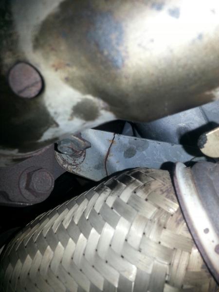

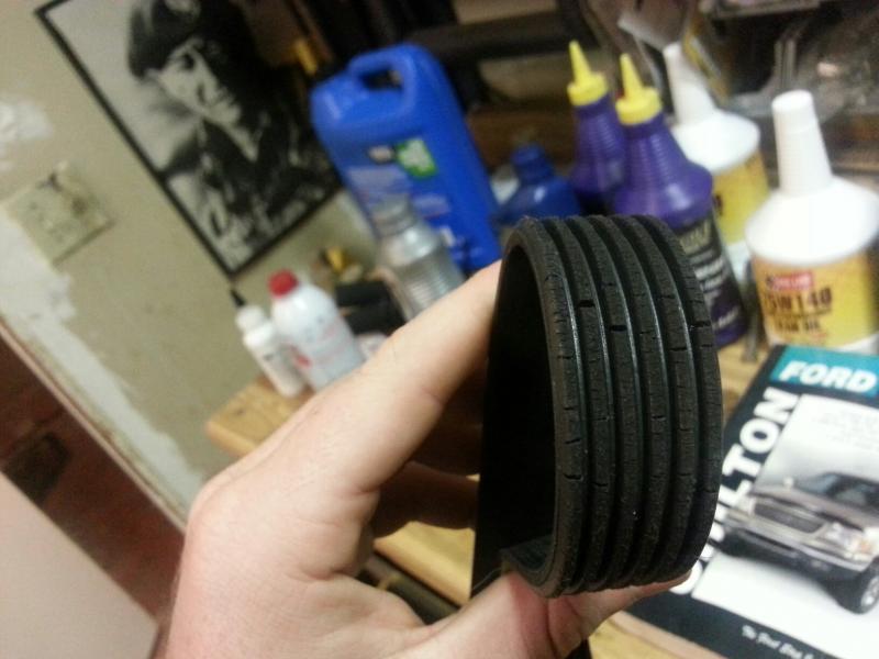

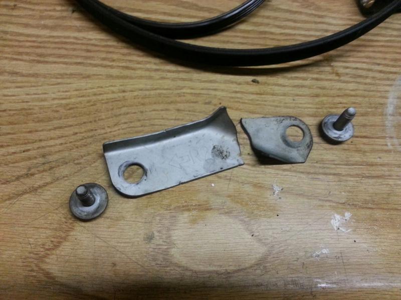

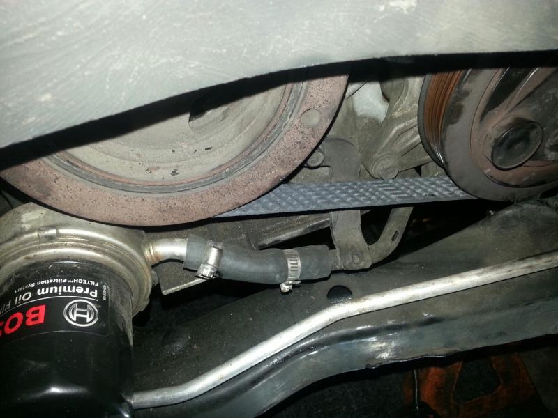

Car was almost due for an oil change so I went ahead and did that, while underneath I noticed the AC/Alt belt was bad so I went ahead and replaced both belts, I get parts cheap through work. Got both Gatorback belts for $20 total. Started looking around for the noise , tapping on various parts. Tapped in front of one cat and it was solid, tapped in front of the other and it rattled. Noticed the mounting bracket thing was broken in half causing the noise. Removed the broken pieces and the car hasn't made that noise for the past few days

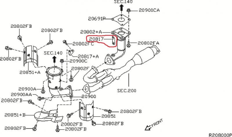

Here's the cracked bracket, easy to find.
And one of the new belts, just because I like seeing new parts on a car. Cheap and easy replacement and will save some headache down the road. I also noticed multiple heat shields and bracketry that could also be prime suspects for a noise like that. If you experience a noise like that, kind of a hollow rattle, just tap around underneath the car and move other parts like the exhaust so you can get an idea of where it's coming from.
