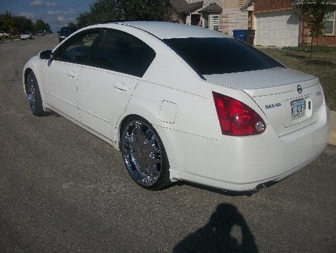

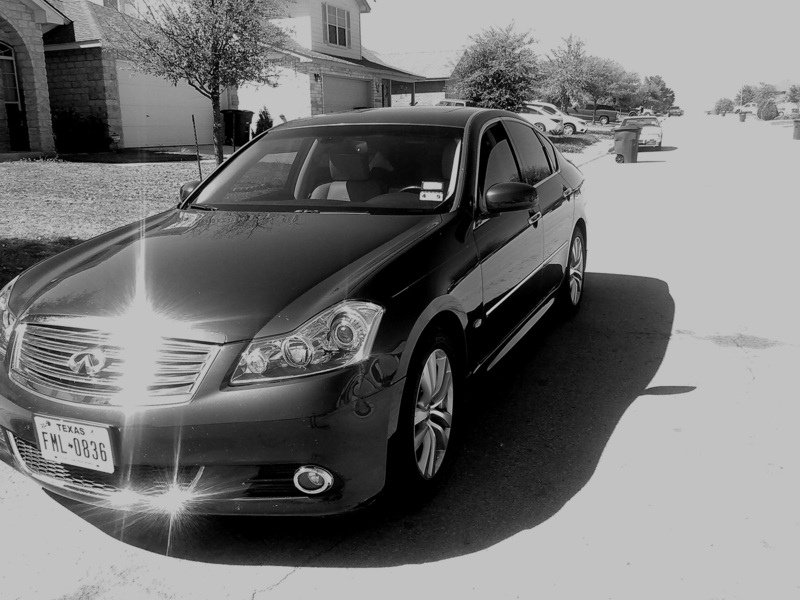

Not to be a hater but I wouldn't buy it most people know my story bought mine in 2011 by the end of 2015 I was over 6000 in repairs. My parents bought one too and it felt apart. traded it for an Infiniti M best decision of my life I was fixing stuff every month you can buy one but know the risks.
