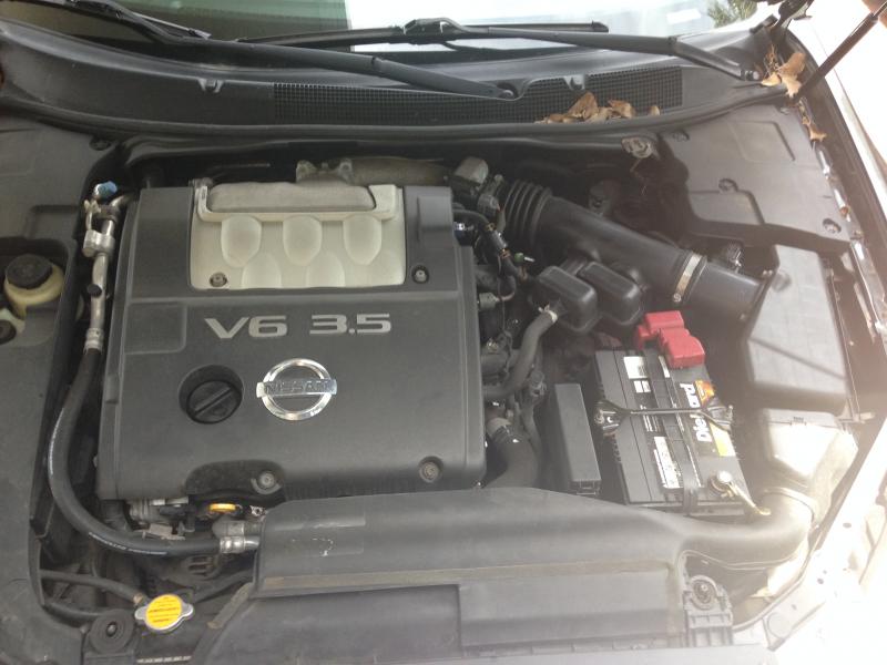

Where would it be here? Being unfamiliar with the car does not help me (the owner is doing me a huge favor by looking & snapping pics.) The only stuff he's seeing is the stickers, but no vin-related stuff.

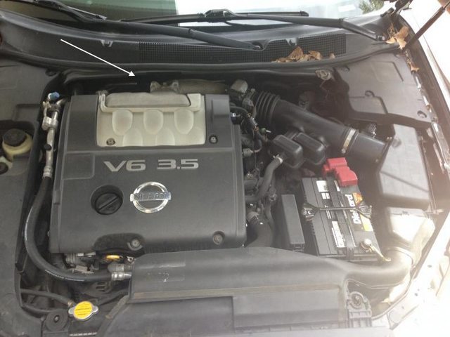

I think? Notice the color difference?
Looks like this

Thanks!
