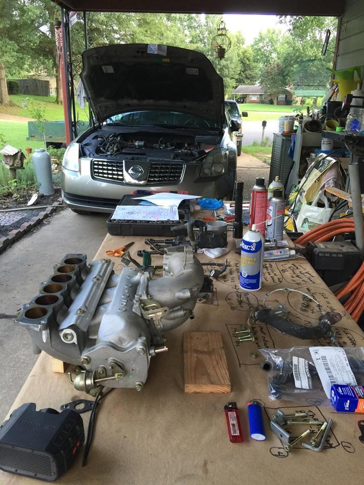

I was having a conversation with myself. I assumed I must be an idiot. But I found what I needed to know so I posted the answers to my undoubtedly idiotic question so the next guy who's unfamiliar with the parts or how or where they fit won't over do it with the shims, or feel too intimidated to tackle what's really an easy job themselves. I've done a hundred brake jobs on other cars, so even though I'm a newbie to this forum, I'm not a newbie to working on my cars. But I've never used these ceramic pads, nor slotted and drilled rotors so i wasn't sure about shimming and shim covers and their necessity. I didn't want to screw em up. But I found out through my own research I was overthinking it. So yeah, I'm an idiot. But hopefully the next guy who feels like he's an idiot for asking an idiotic question will find my answer helpful. Thanks for asking!
I guess I should also add I was getting a little frustrated trying to get my car back together, as I just finished replacing my alternator (WHAT A CHORE!), thermostat, belts, struts, tie rod ends, right CV axle, stabilizer bar connectors, drained and filled my transmission, and it was late when I was trying to get these new brakes on, so forgive my snarkyness. I am currently here: (see photo). Replacing my leaking rocker covers and gaskets, PCV valve, plugs and rear coil packs. So far, removing the collector was 100 times easier for me than replacing that danged alternator!

BTW, I called two local reputable Auto shops, one was Lander Nissan here in Southaven, to get estimates on replacing my rear valve covers, plugs, coil packs etc. that I am currently doing myself because I had read and watched videos on doing it and seemed like a massive and difficult undertaking. That was last week. Neither of them have called, or emailed me an estimate as of yet, as they had promised. So that pretty much forced me into doing this one myself also. I'm glad I did! It aint rocket science. But it does take patience, some mechanical knowledge, FSM's, taking a lot of photos for reference, and labeling everything. I'm actually REALLY enjoying this now. ....and hoping I can get it all back together! HA! Waiting on some parts to ship this week.
These maxima forums, and the shop manuals I downloaded, and the knowledgable people who post on here have been INVALUABLE! As well as some you tube videos. But I've gotta say, this thing doesn't seem like it's put together quite like ANY of the other 6th gens I've looked at. It's definitely been a learning experience. And a good one!
