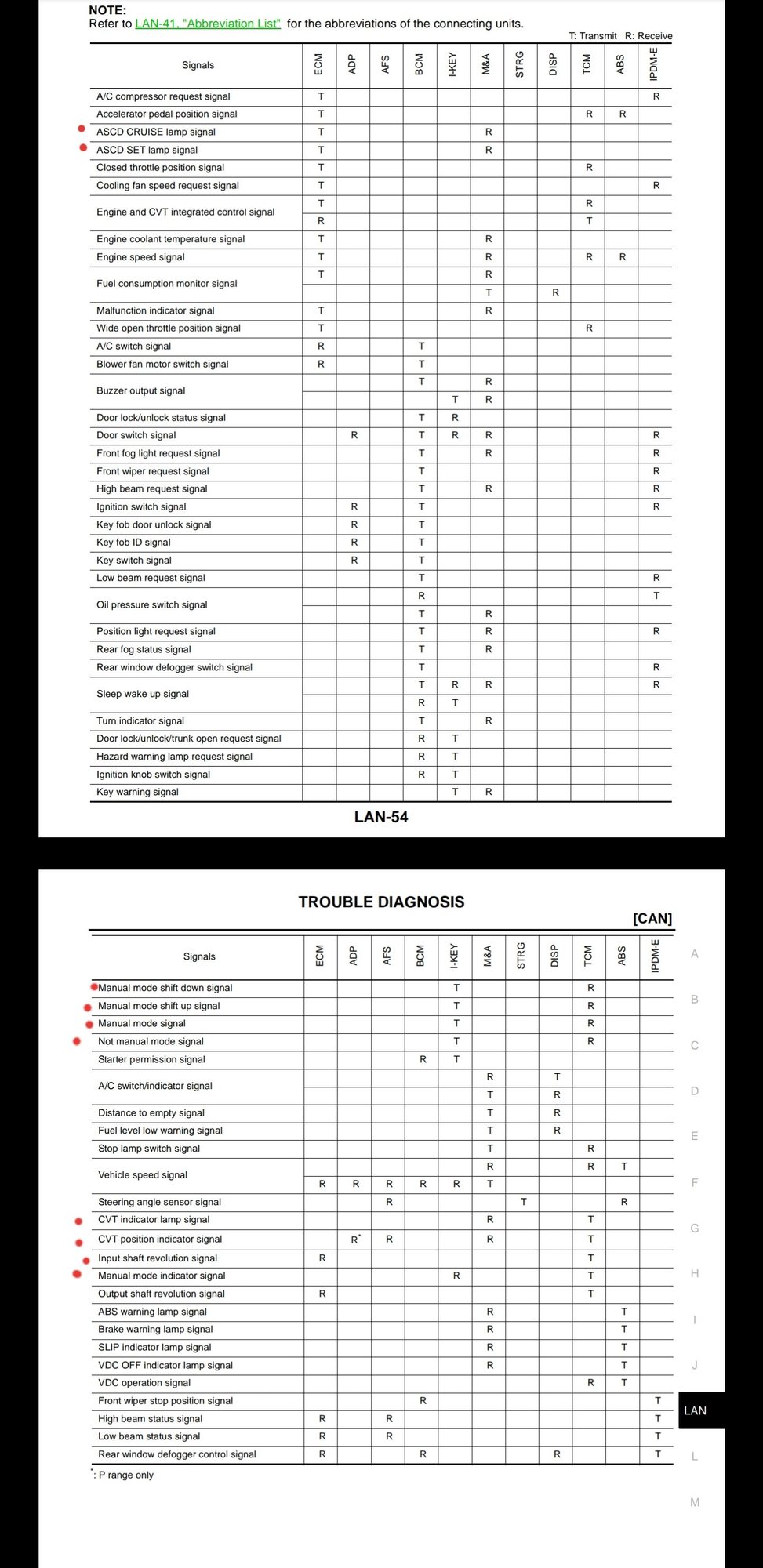

Here is the presage can comm circuit list with the red dots representing the parts my oem vq23 can comm circuit is missing.

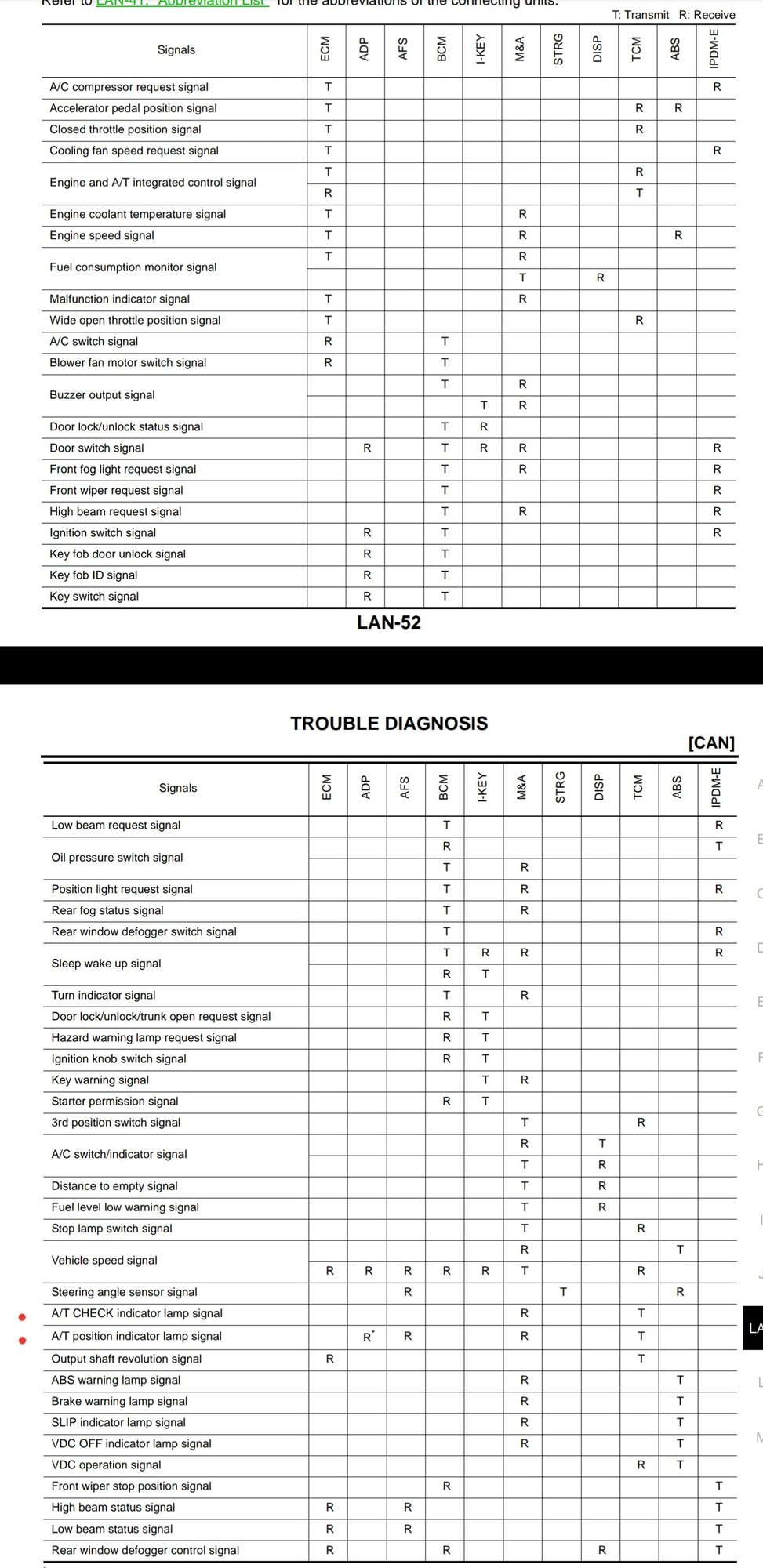

Here is my original car's can comm circuit list with the red dots representing what is not on the presage 3.5. I highly suspect this is a cruise control or tcu related code.

On a side note, my car's platform code is J31, the presage is on the exact same platform and has the chassis code U31. My car has the 4 speed auto, the presage has a cvt. The interesting part is, the L31 altima also shares the same platform and has a vq35de, but also uses the same 4 speed auto trans as my car. So in theory, shouldn't the L31 3.5 altima ecu work with my current set up as it is the same?
