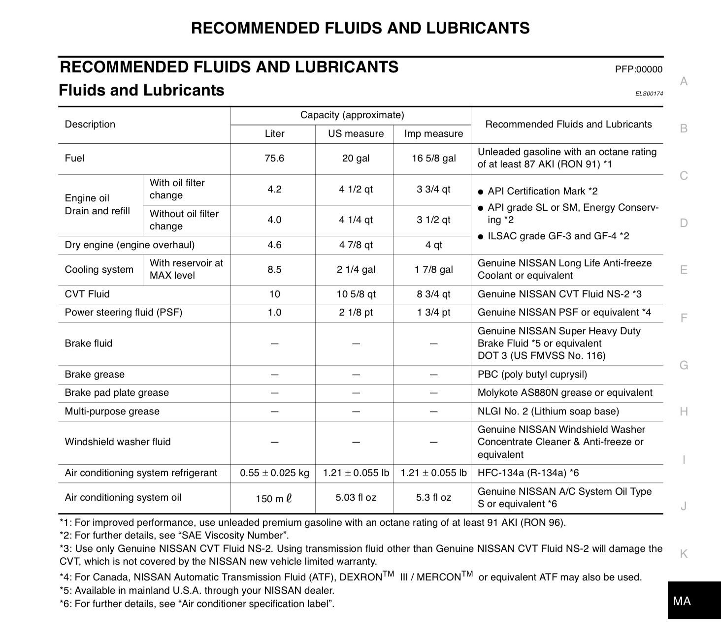

Here’s what your FSM says about fuel octane ratings and recommendations.
Use what you think is best, regardless of mileage.
