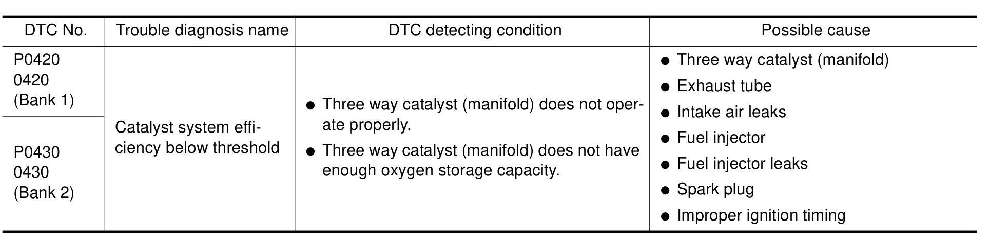

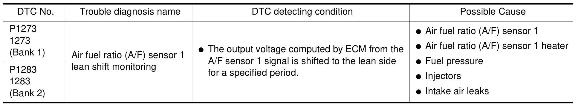

hi all,
can someone please guide me on P430 and P1283 code
is it the catalytic converter bank 2 i have to replace or just the sensor ?
is it upstream or downstream ?
thanks
