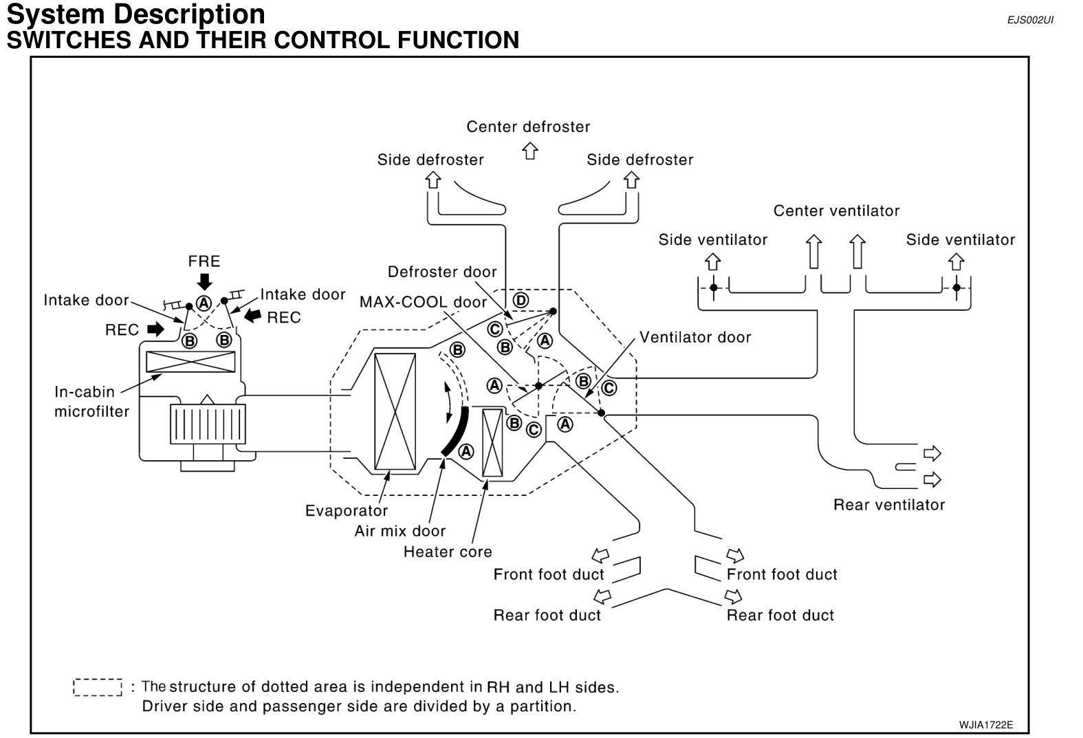

Ah, then I wonder if it is a blend door.
Old Oct 18, 2022 | 08:27 AM
TDGrant's Avatar
Joined: Sep 2020
Posts: 384
The "air-mix" door in particular.

Thanks. Great diagram. I took the motor off and the turned the door manually. It moves freely. Air temp changes minimally when the engine is warm. The motor seems to have full motion when turning in my hand. I have it at a shop now. They've done the same things that I've done, with the same results. The problem is hot coolant not getting to the core. They're trying another process to purge the air from the cooling system/heater lines today. I'll update when I have answers.

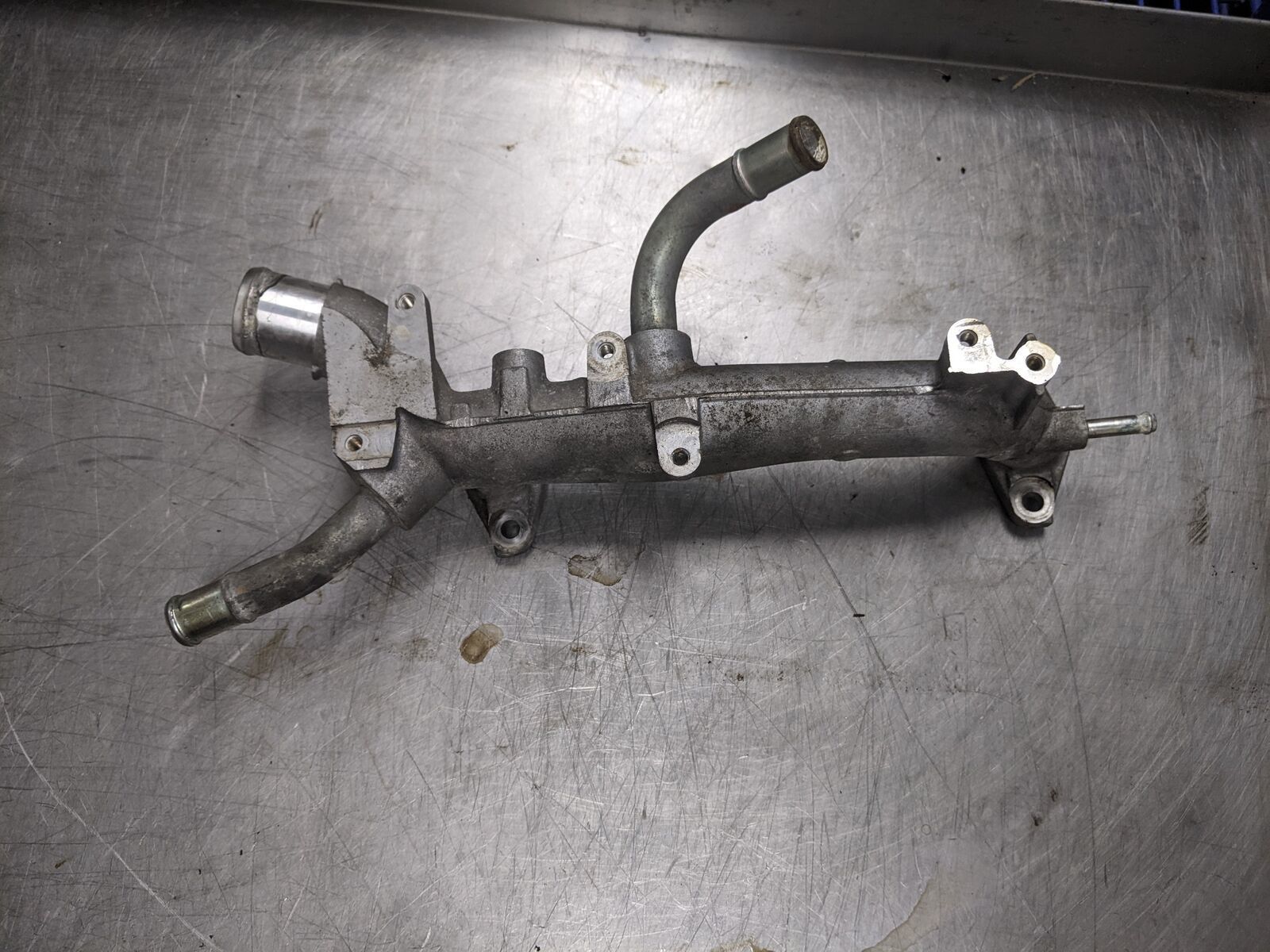

I would have been scratching my head forever on this one. I took it to three different shops before it was solved. There was a blockage in the coolant crossover pipe. My Nissan dealer found the issue after replacing the thermostat, because the thermostat didn't solve the problem.

Upload a pic of the pipe they replaced when you have a moment. Then others on the forum will have a starting point if they ever have an issue like yours.

The dealer was very vague about where the blockage was, as it seems to have several passages.
