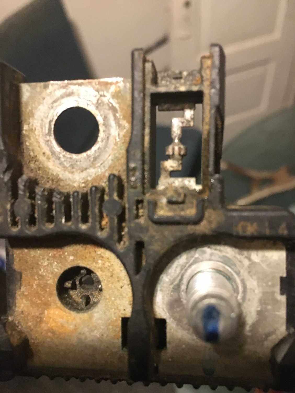

One night I accidentally left the key **** in the radion position but not on, I noticed it 2 days after i last drove the car, of course the battery was dead so i took it to the auto parts store to have it recharged, according to them, it completely charged and still good. I hook the battery up and nothing at all, no lights, interior lights, power or anything, the car ran perfect before that night i left it in the on position, I’ve been reading up that it could be the battery fuse, i pulled it but it doesn’t look blown although a bit corroded. Any suggestions? Thanks. Btw the battery is an Everstart thats 4 years old, it has never gave me any problems.

Heres the battery fusible link. How does this look?

Update even though noone amswered, i went downstairs and messed around with it again, i cleaned the 120 fuse and the entire fusible link, connected everything and got power! Im assuming the battery is very low, the interior lights came on very dim, there was clicking under the dash, and of course it wouldn’t start, so im gonna take the battery to the store and have them charge it, ill update later.

Welp, the battery tested bad, but i kind of figured that… a guess a battery replacement is in the works.

LESSON: always start with the simplest, most obvious culprit. Glad you didn’t go down some electrical rabbit hole.

The Max fired right up with the new battery!!
