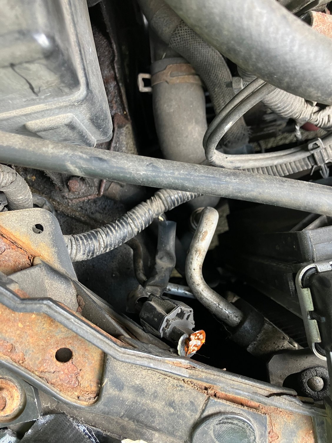

Is this an ac pressure switch?
I noticed this connection was loose as i was changing an passenger side hid ballast, my ac has always worked perfect, after playing with this connection to the condenser, ac no longer works! Can this be repaired without replacing the condenser?

The connsector towards the bottom of the screen with the dark orange back side.

Just did some research, its the AC pressure switch, gonna run to the junkyard later to get another one.

Fixed! Went to the junkyard and grabbed a switch off a 2010 Murano, i had to add a can and a half of freon back to the system.
