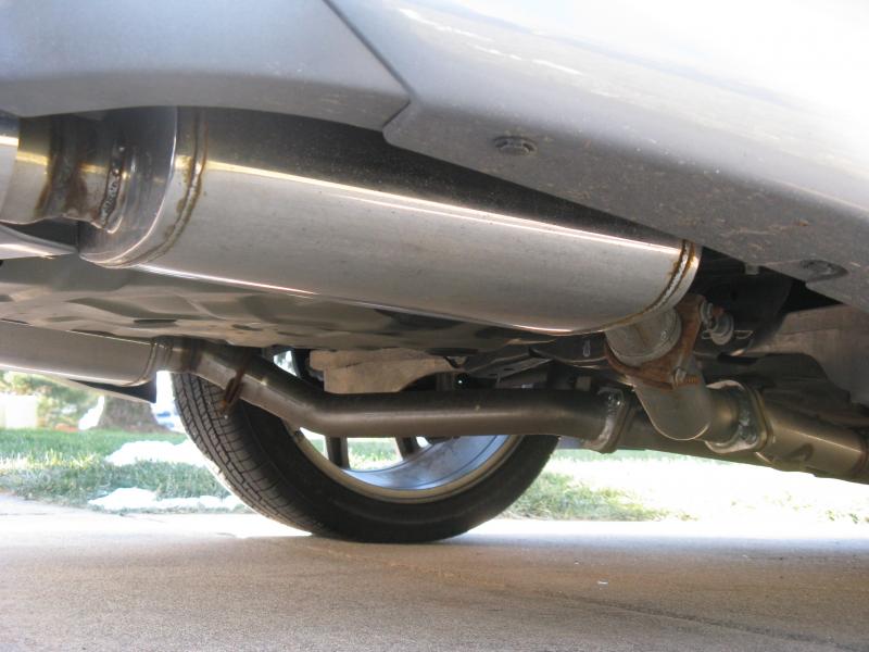

Seriously, the Stillen exhaust is a bit heavier than the stocker. I'd say at least 8-10 pounds heavier. Mostly the mufflers and the resonator section. The sound is great. My only issue with my exhaust is the annoying squeeking from the passenger side slip joint to the muffler. I guess it is the cheap non stainless U clamp needs to be replaced with a better quality type clamp or weld. I did notice on Stillen site that the rear section to exhaust is one piece. Is this an early model?
Attached Thumbnails Stillen rear exhaust insall, some good some bad.-img_1109.jpg   Stillen rear exhaust insall, some good some bad.-img_1106.jpg

Look at the pics a lot closer in Jerome Johnson's post and you can clearly see Rust starting to form, not only does it form in those spots but a hell of a lot around the exhaust tips and inside the exhaust tips as well.
I wanted the Stillen Exhaust but since I've seen the Rust and it is confirmed here that their set up is still heavier than the Stock unit then I feel that there are other options to go with that won't Rust and are not heavier than Stillen's.

I think the easiest and less expensive fix would have a shop that welds stainless , cut the muffler hanger down a bit and re-weld it so it will pull up the muffler . they should charge around $30-$40 tops.
That discoloration around the welds on my muffer isn't rust, but appears to be the discoloration from the welding. I guess the welder they use @ Stillen the amperage was set too high. good for weld penetration but weakens the metal around it. Only rust right now is the cheap muffler clamps in pics.
