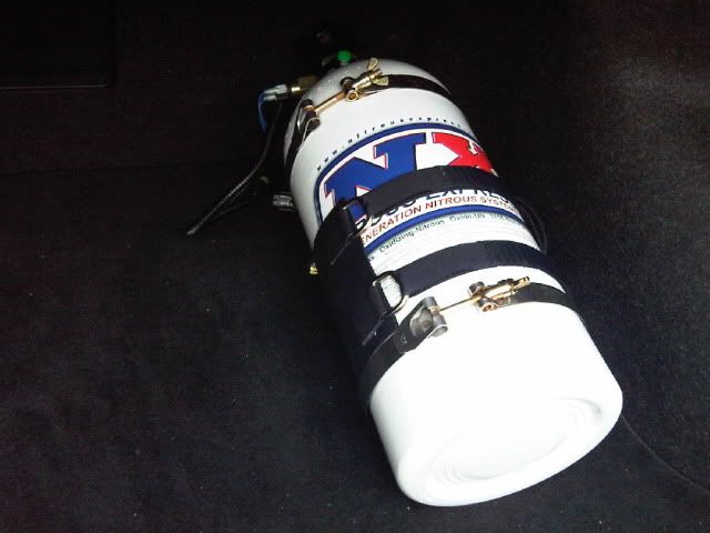

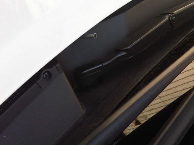

Well guys this is something ive wanted to for a while now a nitrous express nitrous kit with a few extra goodies (bottle warmer and purge kit), despite knowing about the cvt and might not being able to handle the power, ill guess ill be one of the first to see what this tranny can really do .
So far on a 50 shot , ran the car WOT about 30 times and so far so good, Car ran like a beast im really loving this setup so far..... i will be increasing the shot in the coming weeks.
Well here are the pics (sorry for crappy cell phone pics).......Enjoy guys and comments welcome
Purge kit

Yea i realized by being the first to test out this cvt, i could probably finally get some questions answered about how much this cvt can hold....I understand the consequences about blowing the tranny , but someoneone has to do it lol
I will keep you guys updated and posted to say how everything is holding up

Man that is a real nice install. Really like how you integrated the purge and arming switches into and underneath the dash! Can't wait to see some 1/4 mile timeslips in the future!

thanks man, the install was done at a shop here in brooklyn, ny....excellent bunch of guys with a good rep....www.bklynbuild.com

gutting the headers wasnt a good idea, i would throw a bunch of engine codes..etc

yea i agree......next jet size is the 70 shot...Im probably gonna keep the 50 jet on for a while now, see how the tranny/engine is holding up..then eventually ill up the shot

thanks man.......installation along with parts was a pretty penny

yea im deff inching to take it back to the track, ill probably wait for the weather to cool down alil first...VQs love nitrous but hate heat

Annino, well i start off with what i know about the kit , I went with nitrous express for two reason.....Nitrous express is a great nitrous company with a good reputation...another big reason is because they make a kit straighforward for a nissan...here a link to the kit
http://www.nitrousexpress.com/produc...ls.php?id=1459
About using it everyday or on the track, it all depends on you. The setup in my car is i have an ON/OFF switch to engage the nitrous system...meaning when its on , at WOT the nitrous will kick in automatically, When the switch is off , no nitrous is being used what so ever. So i dont have to use it everyday if i chose not to. Also if i used it everyday, it would be very expensive to keep filling up that bottle of nitrous lol....Its 50 bucks to fill up the tank...5 dollars for every pound and the tank i have is a 10lb tank.
The shop said the tank should last about 6 times WOT down a 1/4 track....so you figure 6x1/4...so itll last about 1.5 miles at WOT....and thats not including me purging the nitrous as well which wastes the nitrous as well, but its really cool just seeing the nitrous shoot up in the air from a maxima, Turns manyy heads
