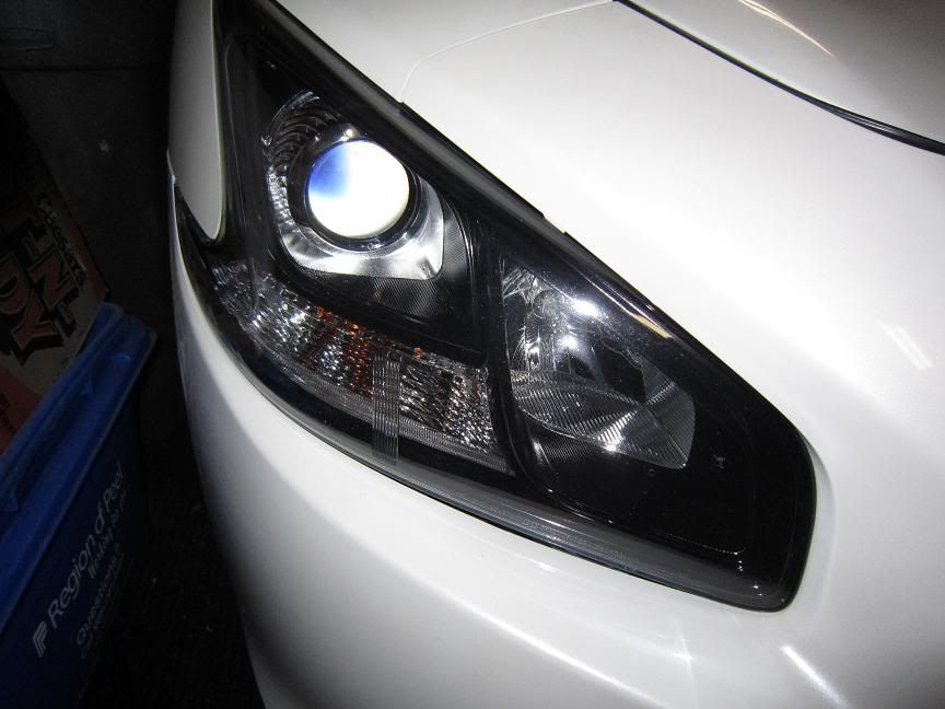

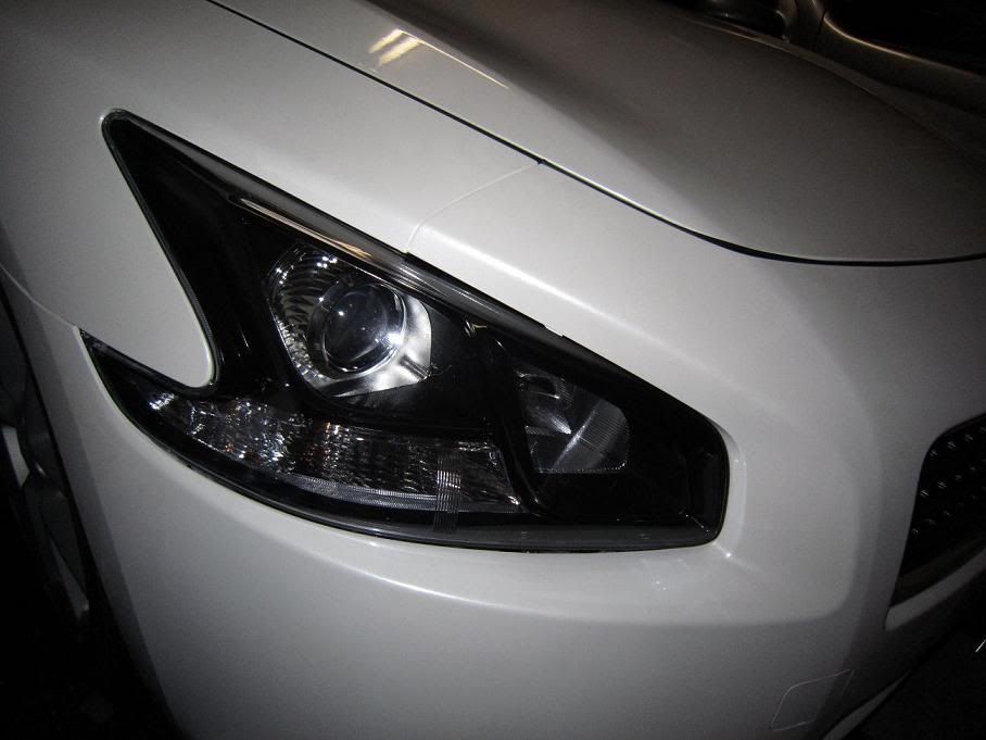

here they are.

Looks good!!!!
Old Mar 13, 2011 | 09:02 PM
Kmoney's Avatar
Joined: Aug 2009
Posts: 1,492
From: Queens, NY
Nice

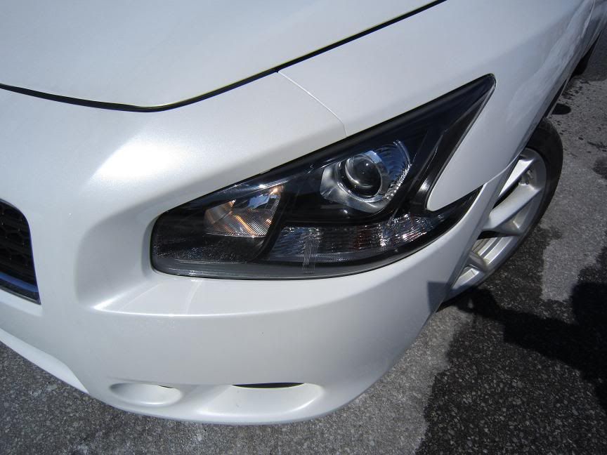

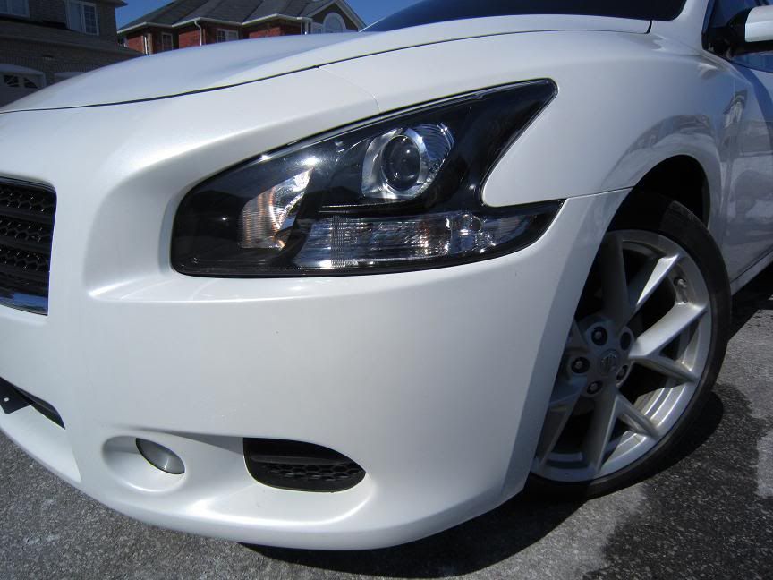

heres 2 pics taken outside today

Looks great. Always a fan of blacked out headlights. Are you going to be attending any car shows in the GTA this summer? or are you a show car guy? Im in the GTA most weekends with my show car. XTS, Importfest, DMCC etc.

Headlights look GOOD

Looks sick, I would love to do this!!
