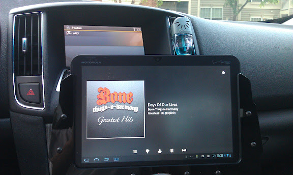

Does this even count as a mod? Probably not because all I did was buy a mount. Whatever. It's a mod. I love it.
Motorola Xoom mounted using PadHoldr. This mount is adjustable in many ways and can come with different size arms to make it highly customizable. Also can have spacers interchanged so it fits different tablets with/without cases. I highly recommend these mounts if you want to get something to reliable mount a tablet in your car - they are even about to launch a second line that comes with optional carbon fiber finish, black gloss, 10 different wood grains, flush mount screws, etc. So definitely something to keep an eye on! A little pricey, but do you really want to mount your tablet with a cheap $50 mount? Me neither. Check them out - www.padholdr.com.
Xoom playing a music video, streaming bluetooth audio to my Blackberry Stereo Gateway that's connected to the RCA inputs
Pandora ftw.

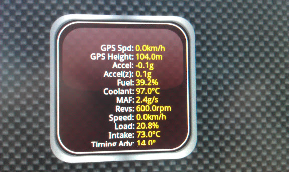

Using the Torque app with my eBay OBDII Bluetooth module to pull info from the ECU live. Tons of gauges/info and can read error codes. Cool *** app.
Close-up
Sample info
Sample info 2

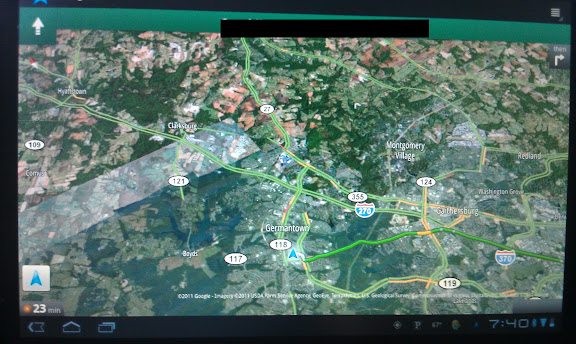

And my absolute favorite...Google Navigation with free traffic overlay and automatic routing around traffic. Crushes the Nissan nav.

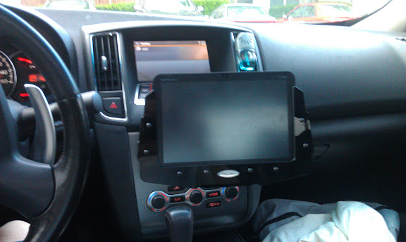

How is it attached to the dash?
Old May 18, 2011 | 06:56 PM
Ghozt's Avatar
Joined: Nov 2010
Posts: 4,020
Using a padholdr mount. It has a piece that attaches to the dash in-between the radio piece and rubberized molding. Had to take off the dash and screw it in behind there but its pretty solid.

Lol...but I had to remove the dash to install...this was harder to put on than my intake so if the intake counts...
Don't sweat the Xoom, it's cool but plenty more tablets coming out too... check out the Asus Transformer it's the same as the Xoom on the inside and $399 for a Wifi one
Thanks for the compliments guys. So far it's been pretty sick, Google Navigation is butter smooth and runs in the background while I have Pandora or a music video running. Nav already found a less travelled way for me to get home and cut my commute from 45 minutes down to 30
For those who don't have Nav and don't want to go through the hassle of installing a new head unit, I'd highly recommend some type of tablet cause they do all types of stuff and can pretty easily integrate into your car. I have the Nav and all that and it still is a pretty sweet addition to the car. Had to leave my screen visible so I can still use my reverse cam. If I could figure out how to get the reverse cam to show up on the tablet I'd fabricate a dash piece to hold this much better and directly cover the OEM screen.

I want to know more about your eBay OBDII Bluetooth module. I heard that the ebay ones tend to be very trouble some (I think it says that on Torque's page). Have you had any problems with it? How much did it cost you and which ebay seller did you buy it from?
Old May 23, 2011 | 12:47 PM
Legendman's Avatar
Joined: Aug 2006
Posts: 86
From: MD
WHOA thats hott getting data from the ECU...! Ok. i think i want Xoom now!!

Yeah it does. So far I haven't found a lot of use for it other than "looking sweet" but I'm sure it will come in handy if I ever need to read my engine codes. There's a very slight delay between when you hit the gas and the RPM needle jumps, so it's not perfect real time but very nice still. Used my OBD sensor and app to read/clear the CEL from my boy's car which he still can't believe.
When I found the app Torque I almost couldn't believe it. My mechanic thinks it's bullsh!t that I have an OBDII sensor for this cheap. Also pissed off a bunch of my friends who have iPhones who went crazy trying to find the same app for their phone. Turns out iPhones need an OBD wifi adapter and don't work via Bluetooth, and their apps are $50+ so just an FYI for anyone with iPhones/iPads. For me this was a ~$35 bluetooth OBD adapter and a $4 app.
FYI if you like the Xoom, check out a few similar Android tablets coming out such as the Asus Transformer and new Samsung 10.1 tablet. They're all the same on the inside, but some have nicer pricing/accessories. The Xoom is a little heavy in my opinion, especially compared to the iPad2, so if that's a concern I'd wait and go with the new Samsung one coming out.
Originally Posted by metalpiotr
Very cool. I am considering something similar in the future.
You're right that Torque does specifically say something about the cheap OBD sensors. I figured at the price it's worth a shot - http://cgi.ebay.com/ebaymotors/Hotte...motiveQ5fTools
That's the exact one I bought, from the exact seller. It's worked perfect for me for several months now. Only pain is when I go to push the parking brake I have to be careful or I'll break off the OBD sensor with my foot. Some other member on here found a way to wire it in using wires and hid his OBD sensor somewhere else where he couldn't kick it.
