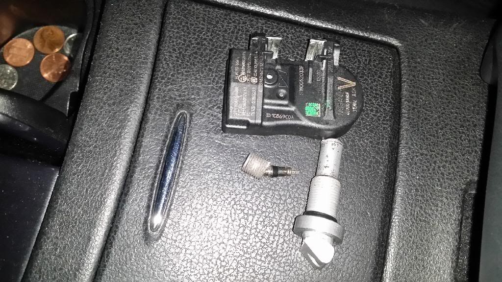

So I went to go get my wheels balanced (at a random shop) and my tire sensor pressure was broken by the mechanic. Now when I went to the dealership they said it might be covered under warranty, but they wouldn't know untill I bring it again Monday (They were closing when I went in first.)
Sorry to jack the thread but I have 35,550 miles and im a college student so im trying to figure out what to say or do to get it replace for free :/
I hate going to the dealership because they just bully me around with bs answers. Any tips or help before I go in tomorrow? Please
Old Jan 19, 2014 | 07:44 PM
GNCMaxima's Avatar
Joined: May 2012
Posts: 441
From: Dallas

Why wouldn't the people who broke it replace it?
Old Jan 21, 2014 | 06:15 PM
GNCMaxima's Avatar
Joined: May 2012
Posts: 441
From: Dallas
Mexican shop and they didn't have the part. The guy was so clueless on how it broke and I've been going for years. I'll rather have the dealership replace it just because I watched him take off my tire and it was loose for some strange reason.
I guess another question would be...Does Nissan cover the TPMS sensors and if they do under what rules do they apply by?
Ive been reading this warranty Manuel and I cant find it.
