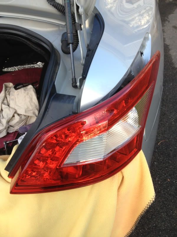

Ok finally figured out today easiest
Way to do . Took all of 2min to pop light out. I wasn't about
To let this mod beat me. Lol
Lights look great
I will post pics and more detail on HOW TO
Old Dec 4, 2011 | 01:36 PM
whit's Avatar
Posts: 433
here are the MUST have tools.
rubber mallet
push pin puller (buy one at auto store for $8 if u dont have- a must!)
wood etc to hit on end of bolt studs so u dont damage anything near
2nd... i highly recommend you insert a very small micro fiber etc along underneath of lights to prevent any scrapes etc....plenty of room to wedge it under.
3rd..EASIEST WAY TO REMOVE LIGHT, took 1-2min and popped out
-after nuts are removed from back of lights, take your Mallet and block of wood ,hit both nut studs to loosen light. youll see it pop out alittle.
-once popped out you can grab corner of light and pull out some more, then take your push pin tool and place in the inside of Nut and push back again car frame to pry light out..all you need to do here is apply alittle pull pressure to the Stud with tool at same time tap screws on inside of trunk a few times and lights will pop out so easily
make sure you apply pressure on stud against car frame and NOT pushing on tail light to push out -otherwise You will crack light . you want to push the tool against car frame with nut hooked with tool and while tapping on inside with mallet those metal studs will pop out and light is out
hope i explained it ok..
Old Dec 4, 2011 | 04:15 PM
Ghozt's Avatar
Joined: Nov 2010
Posts: 4,020
^ +1. great job bro took the mallet method a step further making it even easier. good work man. next time you do it they'll pop right out after hitting the bolts, gets easier each time
Old Dec 4, 2011 | 04:37 PM
whit's Avatar
Posts: 433
Thanks. I agree once there out first time and you know the procedure. It's very easy..
I also agree w your above post . I would never try the screwdriver on side. Your just asking for trouble ...
