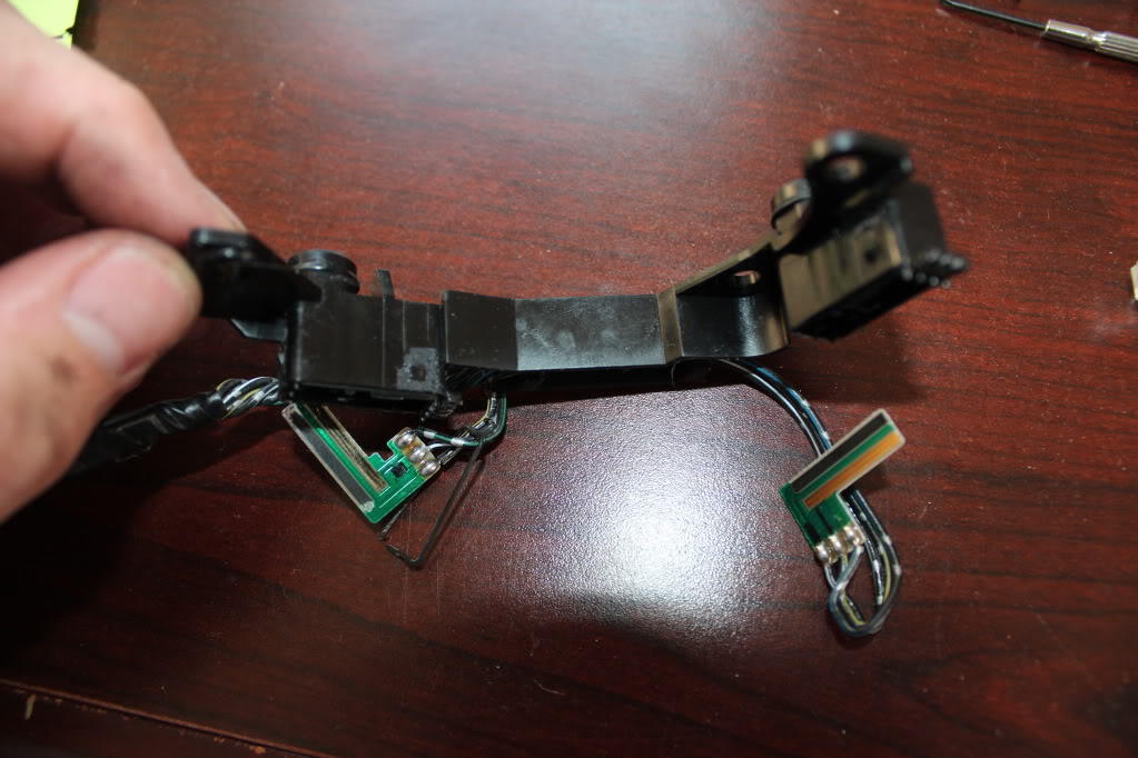

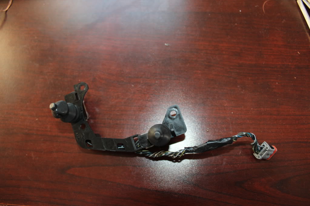

SUCCESS!! sort of. I decided it was easy to take the mirror assembly off, so I did. Brought it in the house and started dissecting it. There is a position sensor that tells the motors when to stop moving in the actuator assembly. These two sensors use a simple resistance circuit to determine the depth. I noticed that one of the contacts had corroded thus making the circuit incomplete and the motors will simply spin until they hit the top of the circuit. I soldered the connections back together, it is a temporary fix, but the end result is that it works again. I need to order the replacement piece but I cannot find it on courtesy parts so I will pay a visit to the dealer to find out. If it is part of the actuator assembly, then it is only $32 so not to bad. Better than replacing the entire assembly. I have a few pics below of the issue and the part.
If you look at the two black strips, one on each of the two circuit boards, you will notice that one has a gray section at the bottom and the other doesn't. The one with the gray section goes to the vertical position sensor and gives me my problems. I simply bridged the gap with some solder and put it back together hoping it would work.

vr4z06gt - I am quite impressed. I am fairly strong with geophysics (my degree field) and astrophysics (minor), but internal automotive electronics leave my eyeballs hopelessly crossed and my little brain in gridlock.
Is that a splotch of mirror assembly grease or a bruise just below the nail of your left thumb in your photo? I would bet you may be the sort of tinkerer than can somehow figure out almost anything. Good luck with your mirror. Like you, I cannot stand to have something clicking or rattling in my car.
Thank you for the complement. That is just mirror grease. I took apart the actuator assembly to see how it worked. I suppose that is the engineer part of me coming through.
