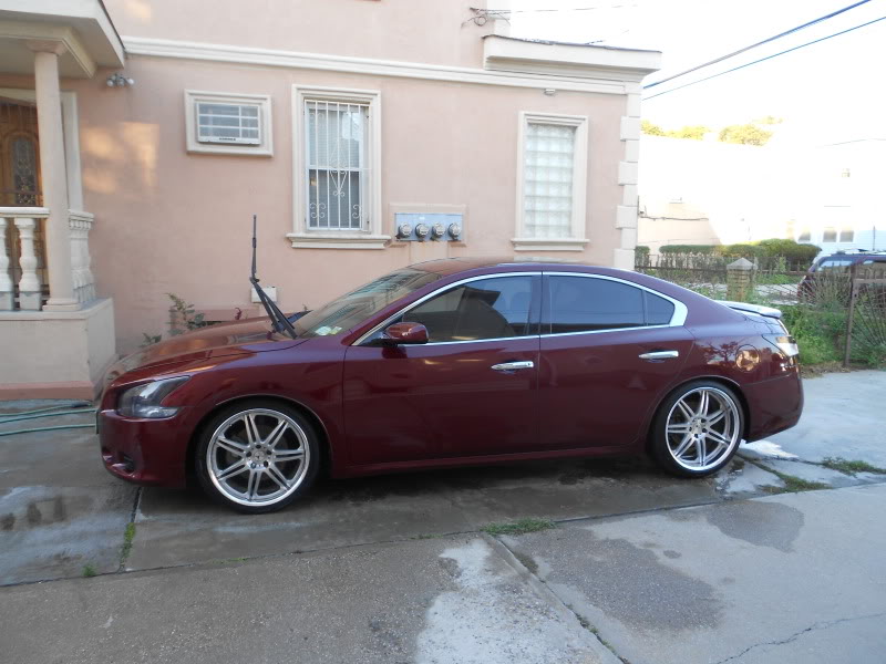

lowered on bc coilovers and wheels are works varianza t1s!

Nice!! Looks really good!
So you are running the rear camber arm?

Yes, I am running the spc camber arms (pn 72050), it is for the 350z but works on our cars. I also have the spc from camber bolts as well!

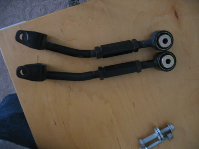

True! You have any pics of the arms as well?
And I didn't think camber bolts would be necessary up front, any part number for the front camber bolts?
SPC 81260 front camber bolts

the rear camber arms comes with rear camber bolts. In order to install them you will have to get the original camber holes drilled out to accommodate the new camber bolt. I would suggest taking it to someone who knows how to do it.
