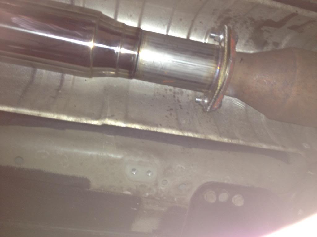

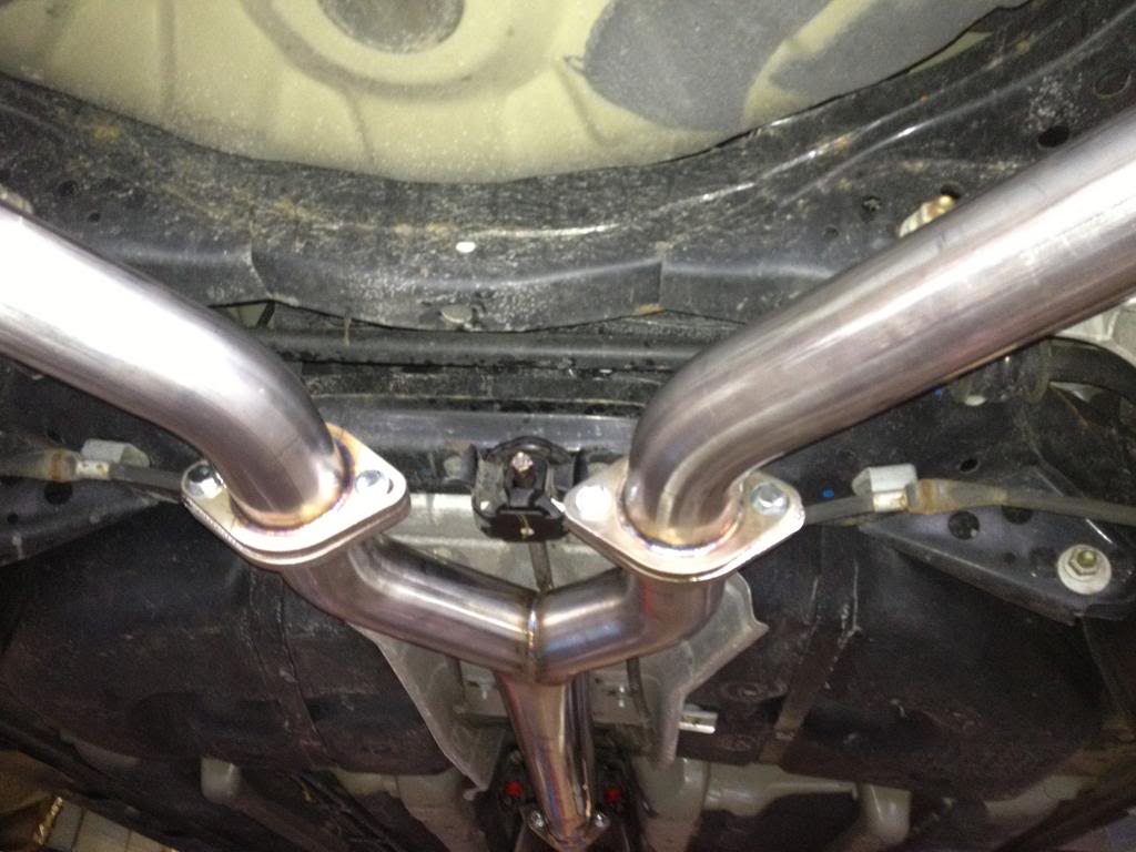

Not sure if this is what you're looking for but here are few that I took during my cat-back install. I'll look around and see if I've got anymore.
I know there are some other threads with undercarriage pics. Look in the AAM exhaust threads, one of the first guys to pick up that cat-back took a bunch of good pics.
There is not a lot of room under there, not sure if a true dual would work without some major modifications to the heat shields. Dunno though.

yeah ive been working with CXJ on the HFC's prototype and there isnt much room for under the car piping outside of what is already run.

The second option makes much more sense. The "true dual" option would accomplish the following....A. Add more weight to an already portly car. B. Going with dual 2.5 inch pipes would kill low end torque. I have run cars making significantly more power with 2.5 inch pipes. For the power level most of us are running its not necessary. The torque curve would move up significantly. The transverse motor poses a lot of problems that you wouldn't see with a rear drive platform such as a G-37. The other issue to keep in mind is cost. The time required to fab up a system and work out all the kinks would get costly. Materials would add up as well. The odds are most people would want stainless steel due to the fact that aluminized pipe would last about 2 -3 years here in the north east at least. There are so many great options out there from borla, stillen, aam etc. if you are looking to have a "performance" system. If you want to just improve the sound there are other options like changing mufflers or resonator deletes. A " true / tuned" exhaust could not happen for any type of practical cost. People constantly complain about how expensive the aftermarket systems are as it is. I couldn't imagine how catastrophic of a flop trying to sell that system would be. Just my opinion. It would be a cool project though.
