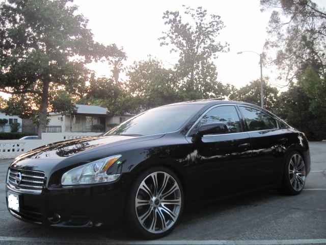

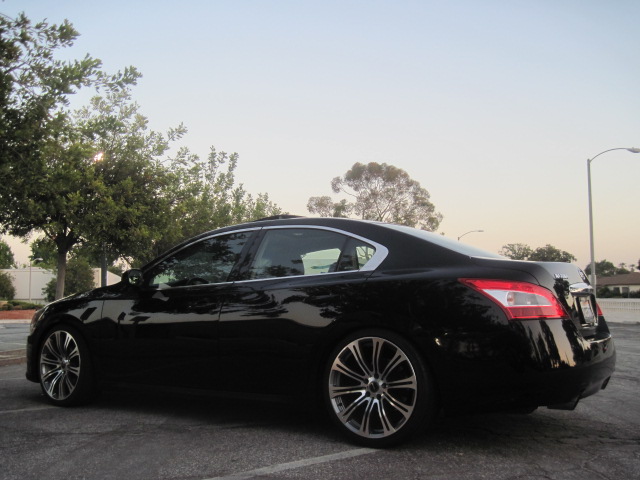

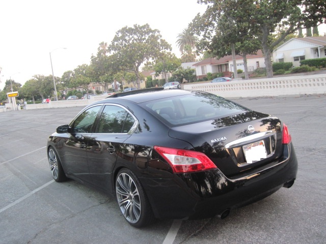

some of the altima and Z camber parts work for the max...hey u looking for wheels ?
I really need to sell these wheels here:

aight! I will check it out for sure g00d l00kz family. also dude selling the rims where abouts are u? cause my one of my boys is looking for rims what are those M3 rims?

Im in so cal.
Ya 20 inch m3 replica wheels.
