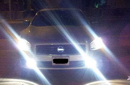

So I was given a set of LED strips (the type you'd usually find in the auto section of a department store) and didn't really know what to do with them. I didn't really want "Audi lights" but this was an option. Then I thought about cutting the letters out of the front Nissan emblem and did some research. Of course I wasn't the first to have the idea, but hey, great minds think alike?
Anyway, pretty much followed Titealty's instructions. My hand is not as steady as his apparently (as the cuts are not as clean as his) and I'm not very well skilled in epoxy work (I may drill out the epoxy later and redo). For now, I'm happy with the results. It was an easy enough mod I could do without spending too much. I'll be swapping out bulbs for LEDs soon though. Realized today my fog lights run ridiculously hot. Pics below. Enjoy!

Really couldn't tell you, man. I'll note that the LEDs don't shine too well through epoxy and therefore won't emit much light. It's more of an accent if anything. Shouldn't be a problem with law enforcement (I'd just stick with white lights to be on the safe side - definitely no blue/red/green LEDs).
Another thing to note - it's mounted with 3m tape. The original tabs on the left and right (the main tabs) had to be cut.

Yup. Just as Titealty did, I put a strip of tint behind it, then filled the letters with epoxy. The LED strip is on the top inner side.

Actually, it's a bit more complicated but not really. My fogs are tapped into the parking lights for power. The fogs are also rigged to a switch (which I will eventually wire into the car). The LEDs are actually tapped into this switch (positive into the hot wire, negative to ground). I'm not sure I can produce great pics of it but it's simple enough to do.
