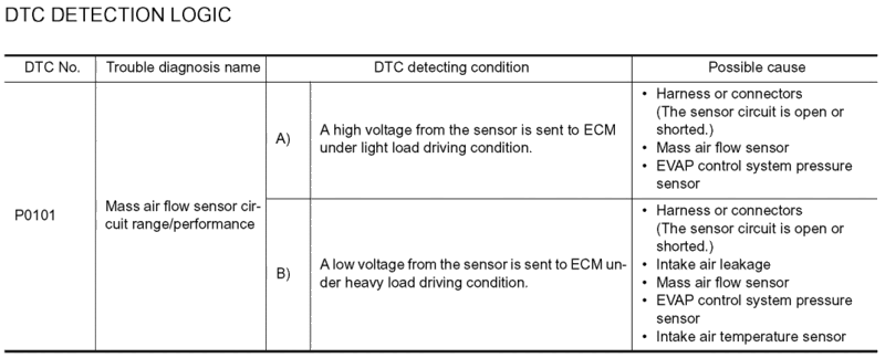

The mass air flow sensor (1) is placed in the stream of intake air. It measures the intake flow rate by measuring a part of the entire intake flow. The mass air flow sensor controls the temperature of the hot wire to a certain amount. The heat generated by the hot wire is reduced as the intake air flows around it. The greater air flow, the greater the heat loss.
Therefore, the electric current supplied to hot wire is changed to maintain the temperature of the hot wire as air flow increases. The
ECM detects the air flow by means of this current change.
I think you prob fvked with the EVAP line putting in the intake and make sure all hoses are secure, i would start by putting back your OEM intake dis your battery for about 15 minutes to clear the CEL and drive it for a little while see if the CEL comes back.
