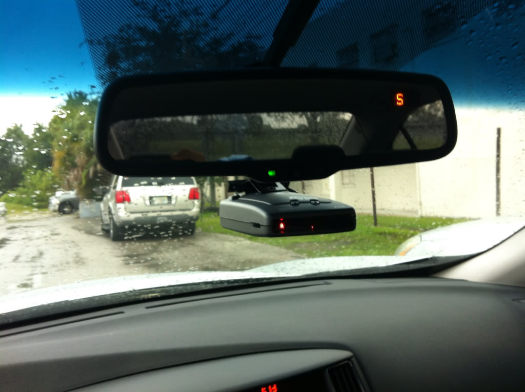

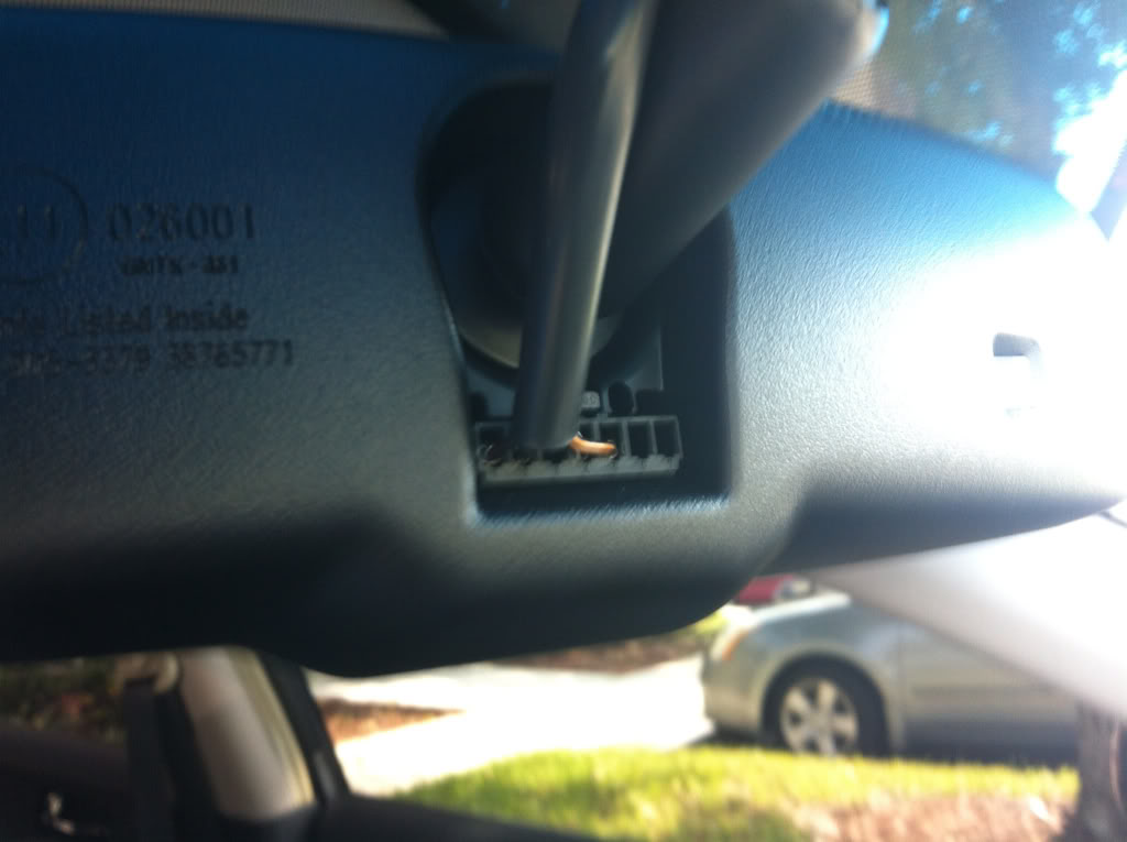

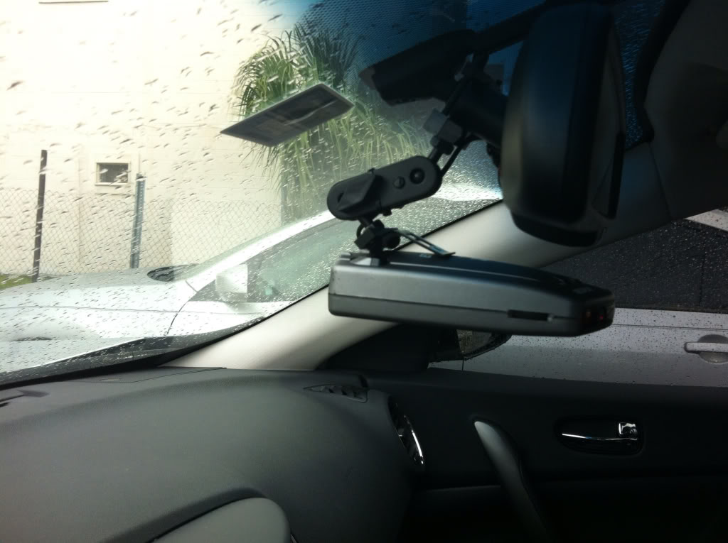

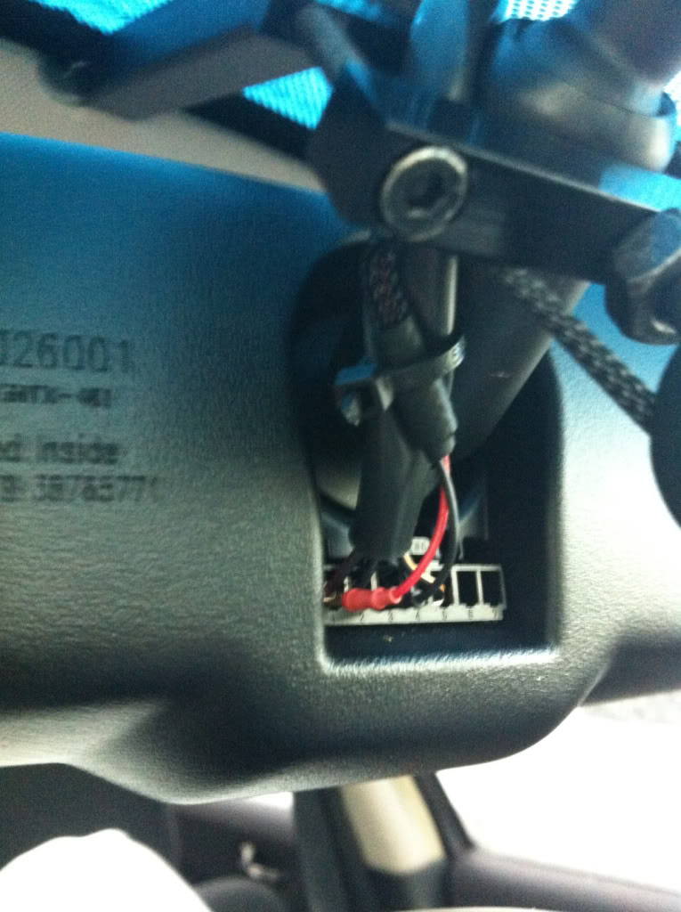

I think the mirror has changed but my 2012 looks slightly different. For all the 2012s out there trying to do this I've got a few pictures.

Highly recommended only cost about 50 bucks took 10 min to install and no wires, best part is now a sun shade fits without having to take the detector down, and detector is protected from sun which is important down here in Orlando
