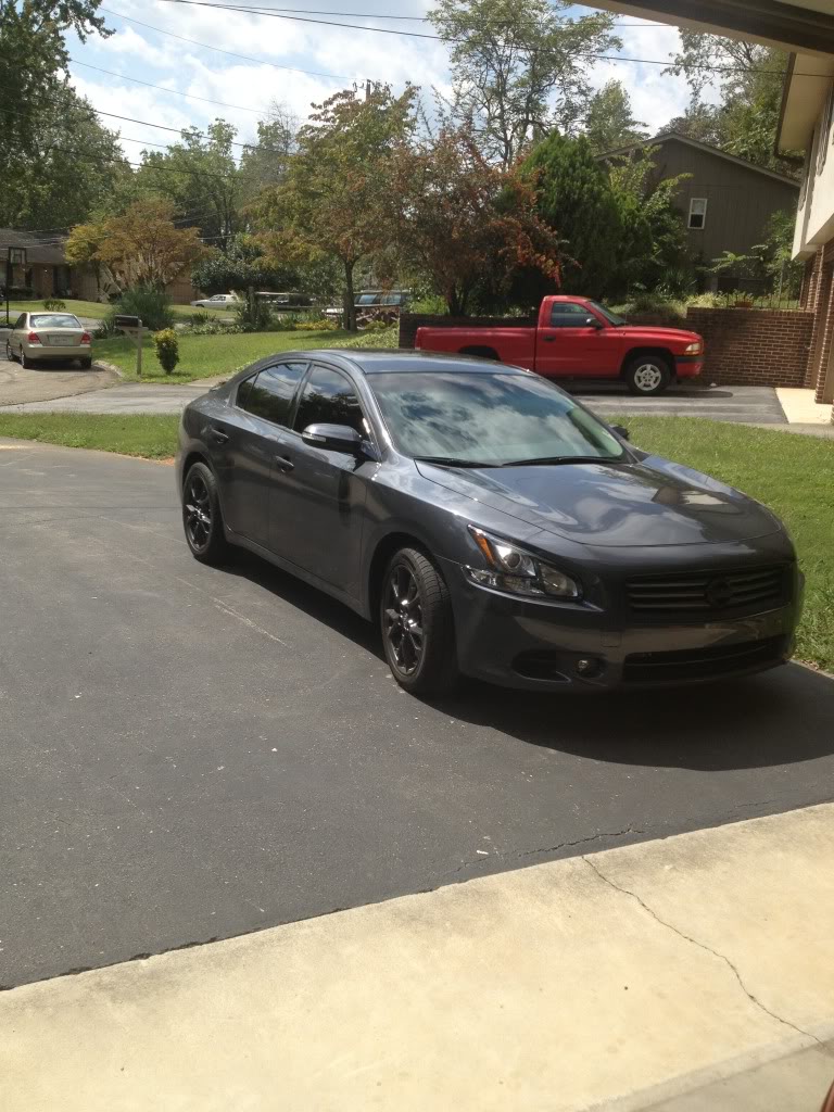

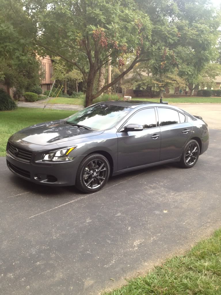

After the spacers
The second picture is before the spacers
So I am still getting shaking. I cleaned them and reinstalled them to 80lbs torqued. It is pulling to the right so I think it is out of alignment but it wasn't before the spacers. Weird? Someone asked me if I bought them on ebay and I did. Is that bad? The company had 99.7% positive feedback. Is it possible that I got bad spacers? It only really shakes at 60-65 mph, is it possible the tires need rebalancing? I am just really not sure what do except take them off. Any suggestions?

Originally Posted by tmo7177
After the spacers
