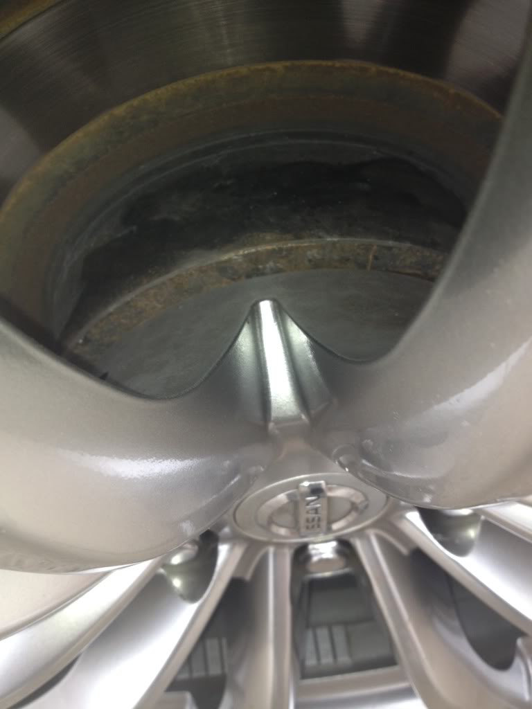

Sorry for the general issue.. Below is a pic of the rear fitment, which is perfectly fine

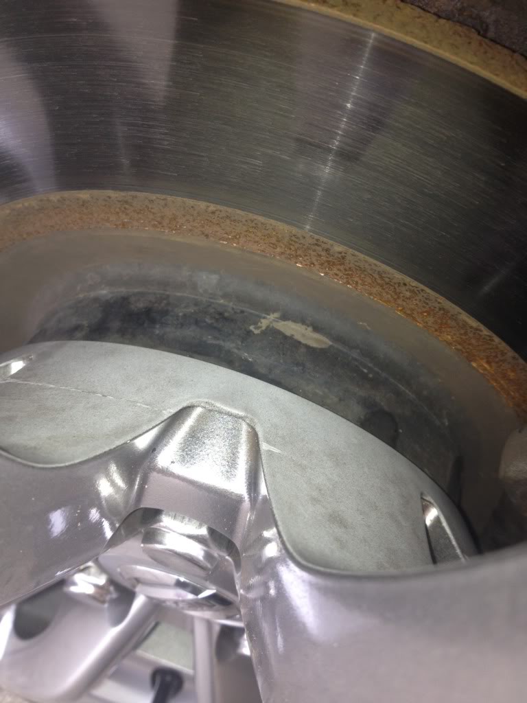

Now this is the problem of the Front. It appears as if I need to bore out the rim in order to get it to fit. I am assuming that any Maxima's that you have G37s rims on them have 19x9's all around.

I posted a pic guys.. Let me know.. I called a local shop and they told me that I need 19x9's all around, but I honestly think spacers will fix the issue in the front.

Do the axle splines poke on 7th gens? Maybe they're hitting the center caps and not allowing the wheels to sit flush.

looks like the wheel is not centering ? are u using the right lug nuts ? what is the seat style on the g37 wheels ? are they conical seats or ? and your lug nuts? are they conical lug nuts ?
they are not centering, they are waaay off.

Got it guys thanks!! The 19x9's fit way better so I put those in the front.. and got 5mm spacers for the 19x8.5's in the rear
