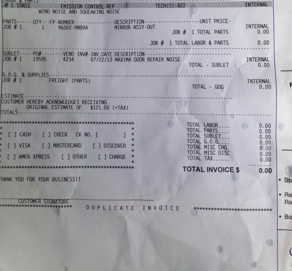

I had the drivers side wind noise on my 2010, the deslership replaced the mirror assembly and that fixed the issue for me. A lot of trial I remember from the dealerships part replacing different weather stripping before replacing the whole mirror assembly to fix the issue
Here's the R/O

I'm willing to bet the noise everyone hears is from the side mirror. I know the drivers side does it and I bet the passenger side does it also but you cannot hear it. The noise is coming from the gap between the side mirror and where it mounts to the car. Drive you car at about 40 mph along a quiet stretch of road with your window down and listen for the noise. Put your hand in that gap while you are driving and the noise will probably stop.
I have gotten used to it so it does not bother me much. Funny thing is my 4th gen had the same issue and I could never figure it out. I think it's a common issue with many side mirrors and it is just the way they are designed.

Tommy, was your car under some kind've warranty? I have 63k on my car and it is CPO.

Yes sortve, I had a few years of powertrain left, but when I purchased this car it came with a "fix all" 90 day warranty when I first purchased it so it was covered with out charge as this issued occursd within the first 90 days. If this was me and u have a close type relationship with your dealers service department id try and bring it in, although i don't believe it's a tsb its a known issue with select Nissans, maybe u can persuade them to help
