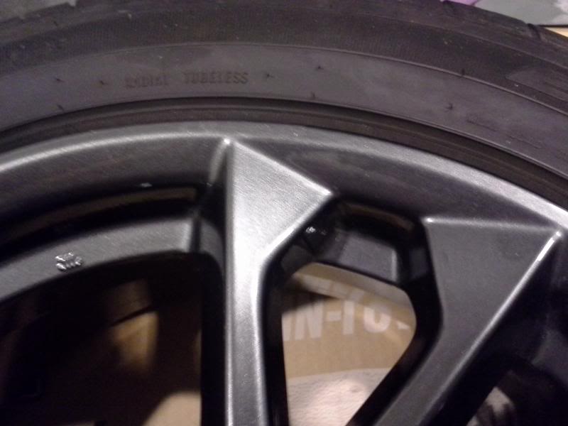

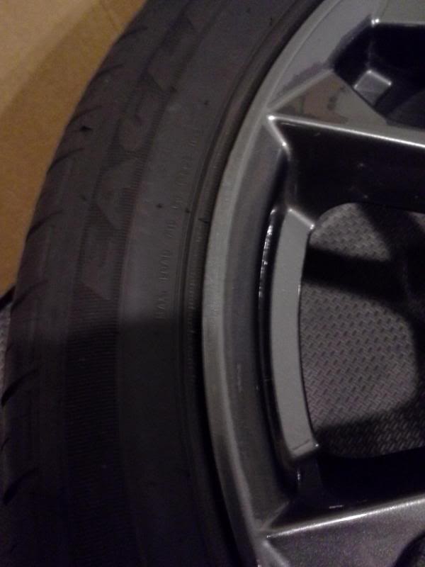

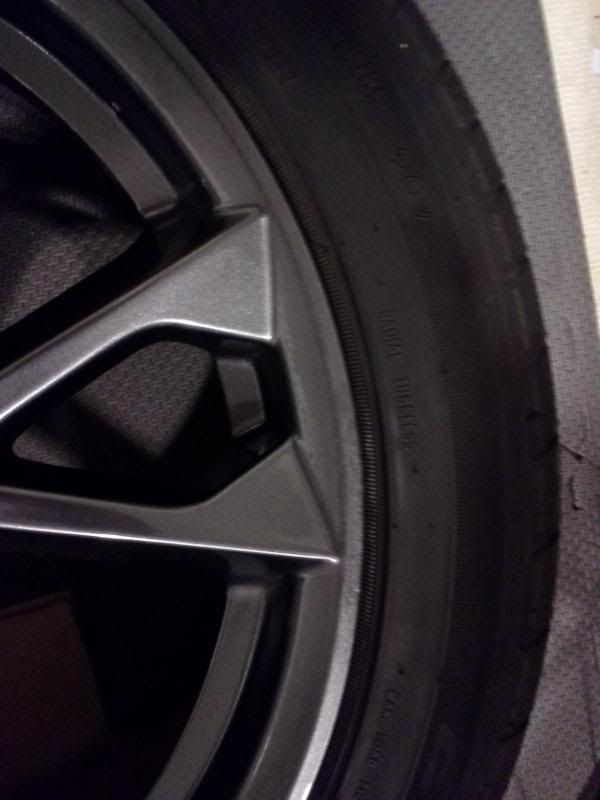

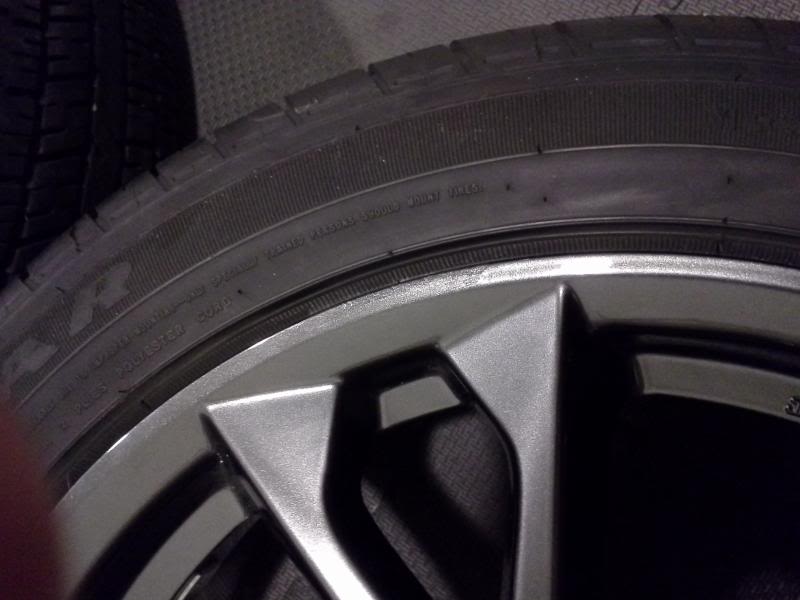

Here are some (crappy) pictures of my touched up wheels using K11 touch up paint to show the color. I would say the K11 is ever so slightly darker than the stock color, but you really have to look at the right angle to notice it in person. The camera really accentuates the imperfections.
I lightly sanded the curb rash to get rid of the sharp high spots, applied 2 coats of the touch up paint with the brush applicator, and then polished the crap out of it to get it shiny and to blend it better. I'll be waxing them in a week or so so hopefully that will help a little too. I originally tried putting a clear coat over the paint, but that darkened the color of the paint and it didnt match well, so I ended up sanding it off . One of the rashes was bad enough that I filled it with JB weld first, sanded and primed it before applying the paint. This was my first time ever doing any kind of touch up or body work so to speak so it took me a bit of trial and error.
Here are the pics. Sorry about the quality, my phone takes really bad photos. You can at least get an idea of the color match.
