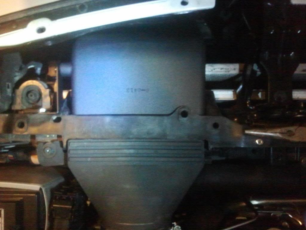

Intake Scoop behind bumper. You can barely see it in the pic. I used a pen light to try and show it.
Top of scoop to the hose inlet.

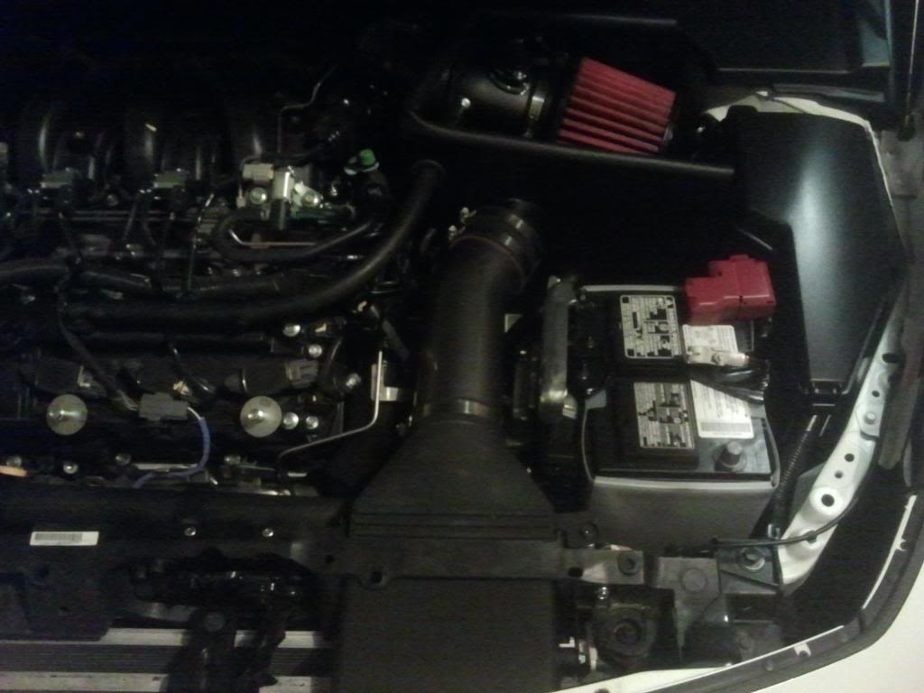

Almost complete.
Buttoned up.
Almost complete.
Buttoned up.

i know you didnt manufacture this or anything, but whats the purpose behind the new scoop that brings in air from the grill? its got the same fitment as the R2C has with the stock one. the heat shield is still open on one side. air is like water it takes the path of least resistance, so if it can pull air from the open side an inch away vs down a thin plastic tube it's going to be pulling much more air from the engine bay than you think.

The basic purpose of the scoop is to direct the cooled air from driving/moving at speed directly into the heat shield where the filter can suck in the air. While driving it keeps constant outside cooled air in the box. I was worried about the rain, but it was raining fairly hard yesterday and the car drove fine through it. I forgot to open the hood and check for water though.

Right, I was jus saying that's the basic purpose of the OEM scoop too. Unfortunately it doesn't work well with the R2C intake that it butts up against cause the side of the heat shield is open just like this one. Someone should do some testing with this like I did with the R2C
