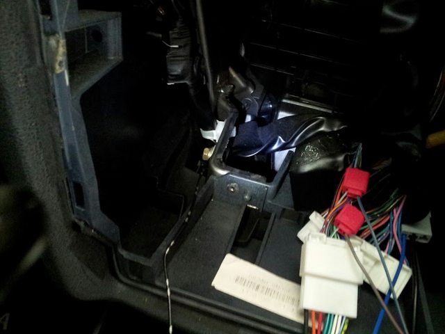

3) Where did you select your ground point? Did you make one? If you look in the pics below, the last one shows the ground to that L joint I made using a bolt and nut. The Axxess ASWC is grounded to that line (shared from the HU).

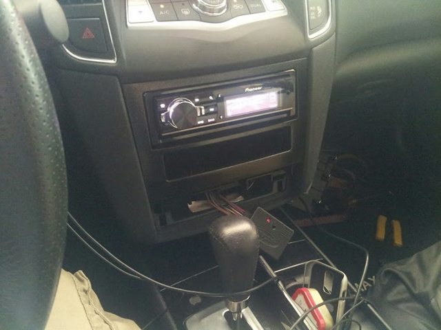

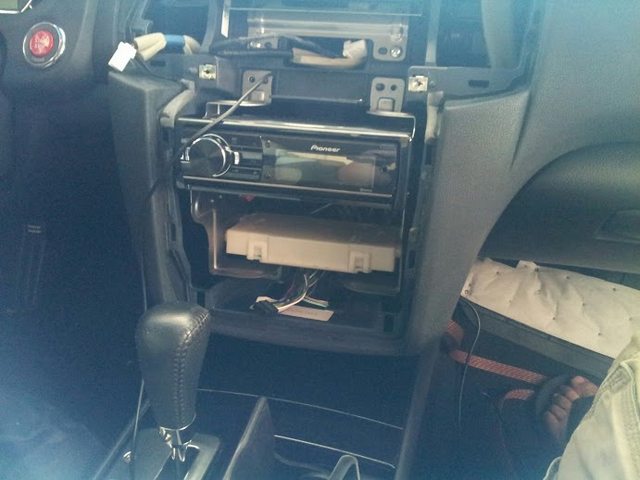

Anyway, some pics of the install for your viewing pleasure.
Alright just a short update: so I pulled everything out this morning, cleaned up the ground point. Reinstalled everything.
Got the volume to work. 3 buttons and one switch to go~
