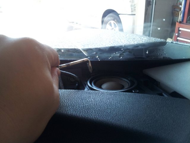

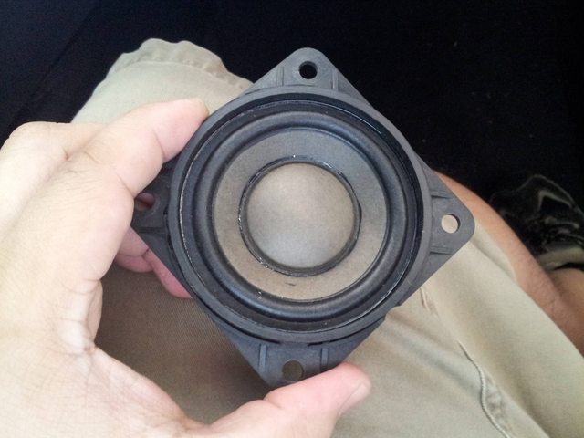

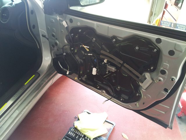

The fronts (on the dash) aren't 4". Definitely 3". Here's some pics. Unfortunately, I don't have any of the rear doors (and I don't know why...).
Front door.
Stock tweeter.

Thanks Shipwreck, I'm gonna be stripping out my car tonight to get ready for tomorrow when my buddies come over to work on it. I did buy 4" JL's for the front tweeter part since it stated in the service manual that they were in fact 4", so hopefully I didnt screw myself lol. Thanks for the info though, I'll try to remember to take pictures and I'll post pics of all four pairs of speakers.
