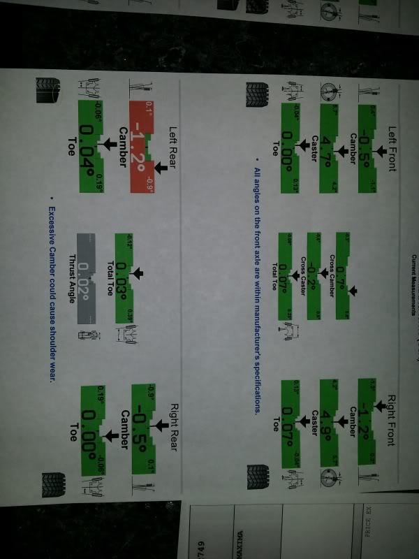

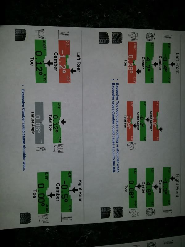

Everytime I get my alignment checked my back cambers are off. Anyone else have this issue?
31k miles (lowered at 25k)
Gotten 4 new tires (at 25k)
2 alignment since then
Any thoughts?
Thanks
***Before***
***After***

The specs you posted of BEFORE looks like the front was hit or a new part was replaced. The AFTER looks like you need camber bolts to get your camber equal up front and as far as the rear that little bit of camber difference should be able to be equaled out.
You're getting a "pull" because your camber is off from one side to another.
Also for better handling you want about -1 degree of camber all around.

has the car been in an accident? on eibachs i was able to get in camber without camber arms or bolts. i needed that stuff when i went down on coils. but as someone else mentioned the before of the alignment looks like maybe there was an impact

Yeah my front right hit a curb pretty fast but all the parts were replaced.
And yes I am lowered but dont have the Eibach Camber bolts yet

OK a few things:
1. The tech that said "import" suspension will do this is nuts. Its not a import or domestic thing. He sounds like a guy with leafs and a solid axle.
2. The left side of your car has issues. The toe issue on the front left was causing a pull and tire wear. The rear left camber is not a huge issue provided the other rear had a similar reading but it didn't.
3. There is still a camber issue on the left rear BUT the right is OK, something is bent on the left rear.
Negative camber at 1 degree is not a huge issue, any toe problem IS a big issue. Your car is still not good, find out what is causing that left rear camber and get it fixed before doing another alignment.
