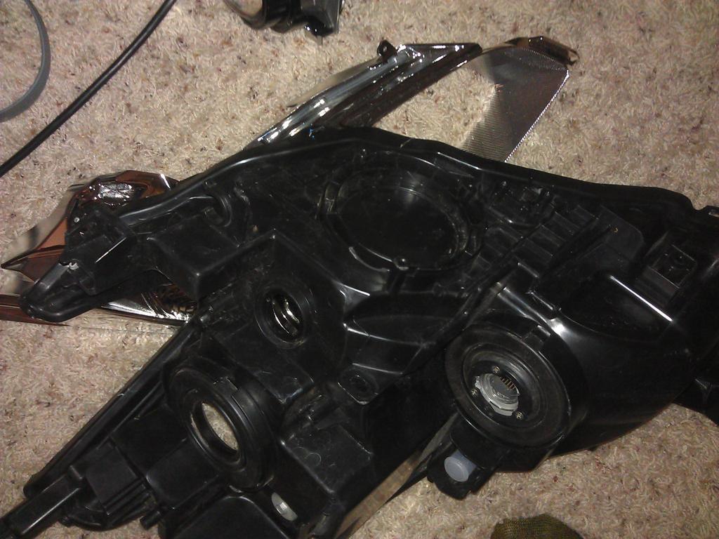

This is one of my old halogen headlights, yes there is a spot for the OEM ballast to go, but if you go with an OEM ballast you will also need these: http://www.theretrofitsource.com/pro...roducts_id=244

just go aftermarket. you'd spend more work modifying the factory wiring to plug into the OEM HID ballast than is necessary for a project like this (adding HIDs). also the location of the plug on the ballast is on the inside of the light, on this halogen headlights there is no opening where the mount location is as you can tell from the pic
