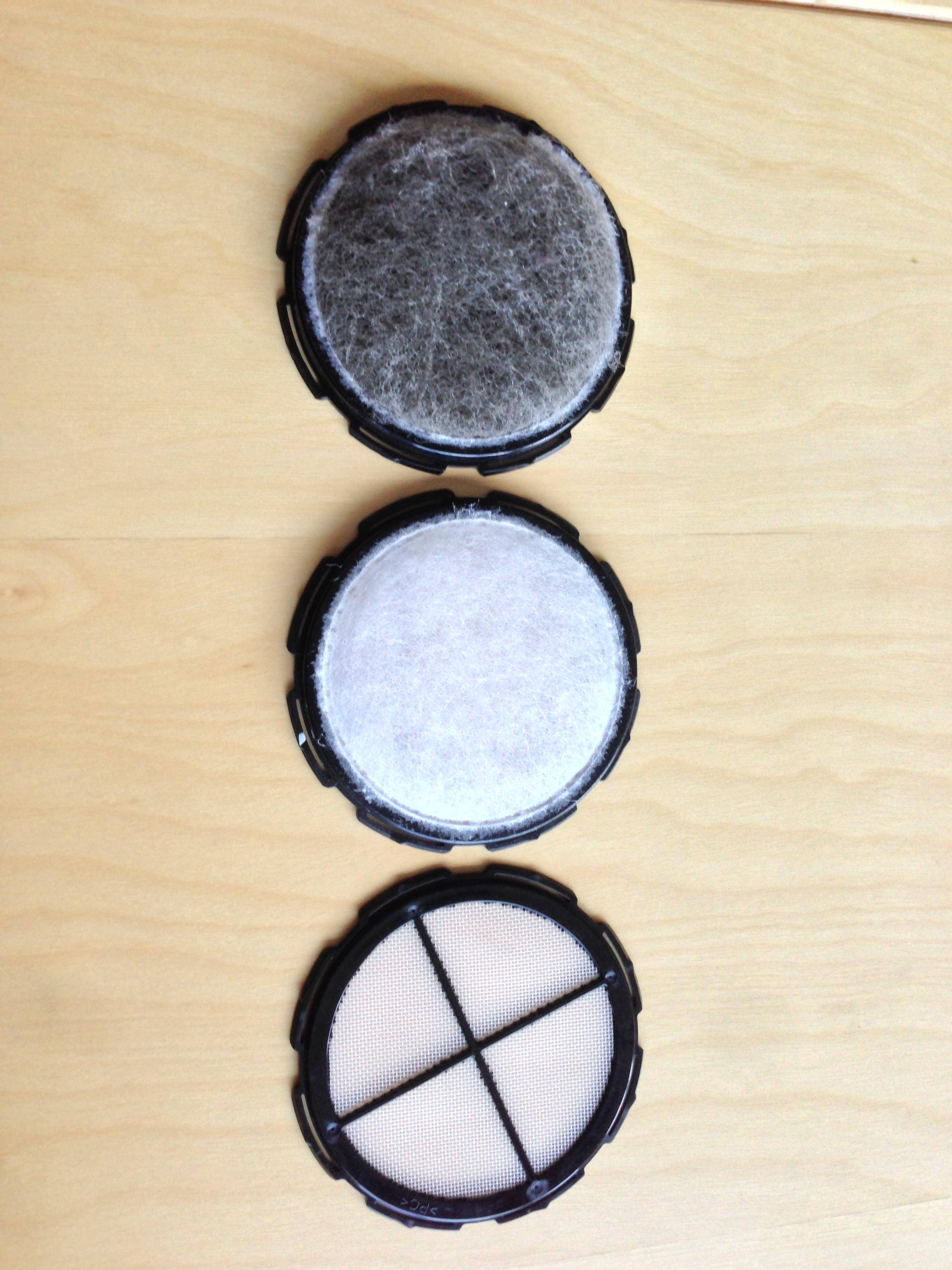

Make sure you change out the filters on top of the fans, here is a picture of my dirty ones compared to new one!
So the dirty one is one top, same type of filter replacement underneath it, and they have a new mesh style filter on the bottom (best performance)

My filter is brand new. As is the vehicle. I may try running the system without a filter just to see if the improved airflow makes a difference.

Where can I get a new filter? My issue is mainly with the cooling aspect... The heated setting seems to be working 95% of the time...
Be careful running without the filter that fan is really close to the floor and debris can easily get sucked up in there.
