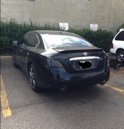

I taped mine off, spray tinted, sanded, clearcoated and sanded again myself. It's a process but I love the turnout...I get people thinking I had a body shop do it! 😎

Originally Posted by maxipad2011
Your taillights really look good! I wish I knew of a local shop that I can get this done.

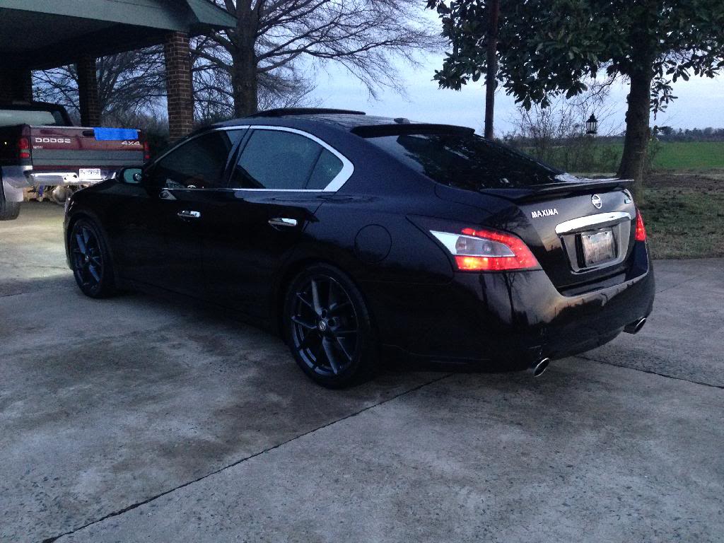

I used Nite Shade on the lights and sanded it down. I did a complete spray because I felt that if I taped off the brake lights, there would be an edge from the spray between the two. Let me know what you think!

Originally Posted by Rocky Davis
They look good how is the paint holding up on them and how many coats did you do.
I removed the tail lights and used Nite Shade. I did two coats. So far, it's been holding up really well, no imperfections.
Thank you brother! I think you could do it yourself though...honestly after baking/opening my headlights to paint the housings I wish I would've just done the same with my tails and tinted them from the inside. You could do it though!

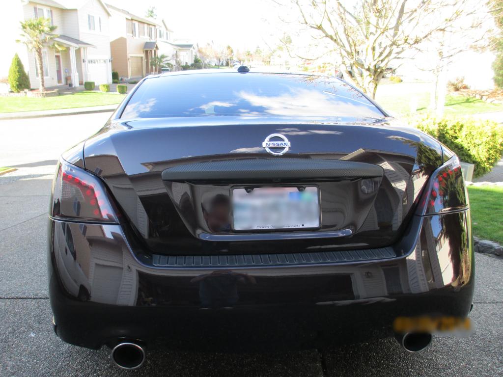

Do it right and legal....
@dr_2010SV: do you care to share how you did yours and do you have any other pics also? Yours are my favorite I've seen on the site.
Not sure I have the gumption to do it myself (don't wanna f 'em up) but yours are really well done so I figured I'd ask

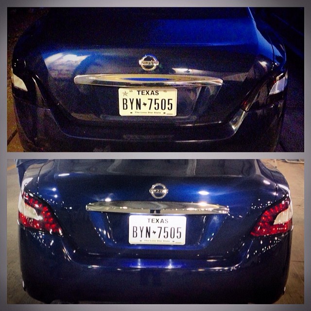

Painted
Bro that is badass! Where did you get yours done?
Old Apr 4, 2014 | 04:48 AM
dr_2010SV's Avatar
Joined: Oct 2010
Posts: 1,326
From: WA
I did them. The trick is masking each single LED light location so they get no tinting. Then do your Nite-shades and clear coating. I also masked the turns/back-up so they only got one coat of tint. Now I need to work on the front lights.
Great work dr! looking good. What clear coat did you use over top of them? Looks shinny and I've been skeptical for the nightshade cause it looks flat in many cases.
Cheers.
Old Apr 5, 2014 | 10:42 AM
dr_2010SV's Avatar
Joined: Oct 2010
Posts: 1,326
From: WA
Thanks, I'm not sure since I pitched the can quite a while ago. Just remember to get a clear coat made for plastic's and that it has UV protection. Check out some of the You-tube videos for Nite-shade application.
Look at that big ol' booty! I like the look of those lights. They do look very clean and solid! I want to get that done to my Max ASAP!
Old Apr 9, 2014 | 07:47 AM
dr_2010SV's Avatar
Joined: Oct 2010
Posts: 1,326
From: WA
Thanks, I really wanted to do it so they would look as OEM as possible. Been tailed by LEO's numerous times and have had zero issues.
