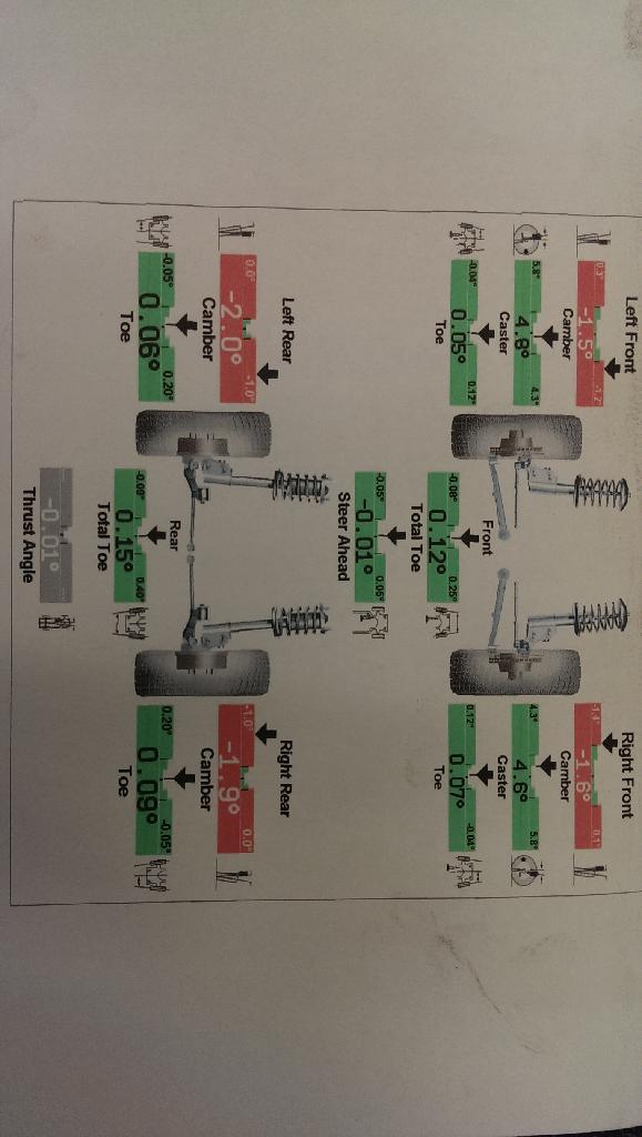

Toe wears tires much quicker than camber. Here's my specs. I did it this way for handling and flushness.

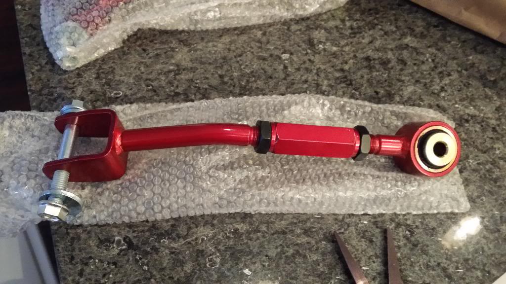

I have the same issue but I just got my camber kit in the mail so let's see if this will fix issue. I had -2 in the rear!

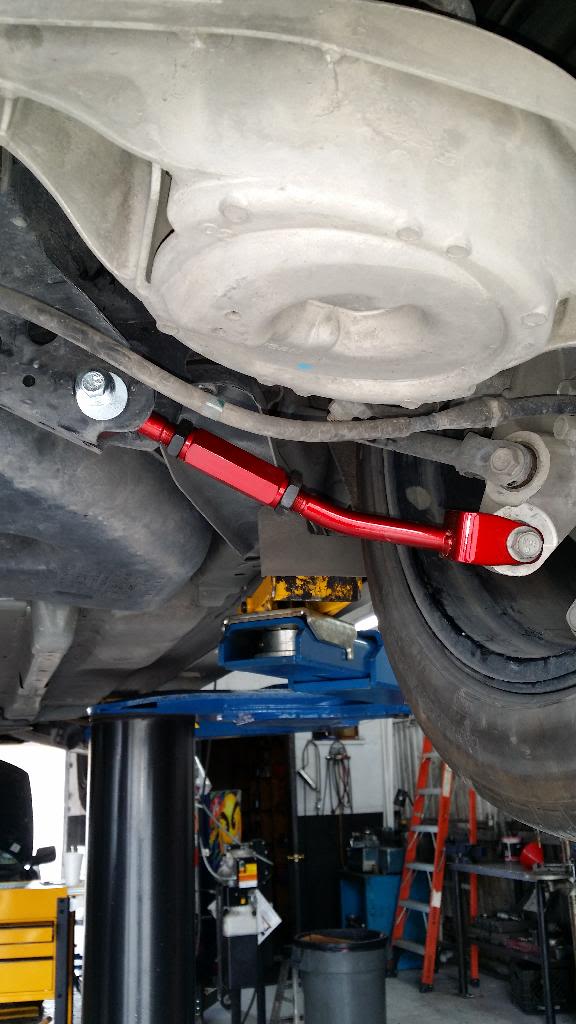

Which one is the Toe bolt? (noob question)

Remember, at either location you are affect BOTH camber and toe adjustment. You just affect more of the toe at the lower link and more of the camber at the arm.

You will see from this video that they are applying it to the lower link and not the camber arm.
http://www.spcalignment.com/componen...AFrom&to=USATo

It's the bolt that attaches the spring bucket arm to the subframe
