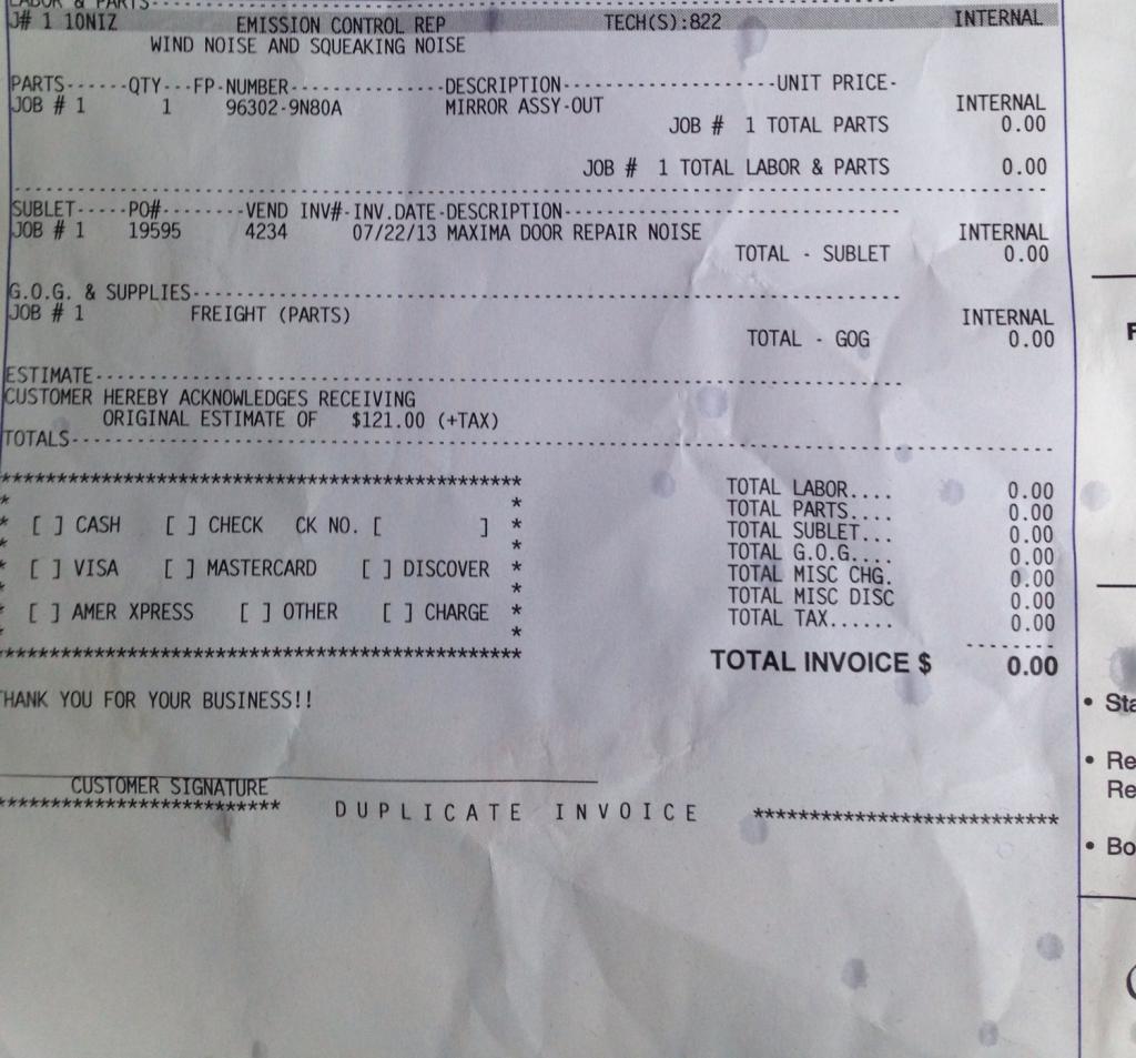

can you post the receipt for the work here?
Don't mean to doubt or offend you, but it might be very helpful for us to print it and take it to the dealer. I know what my dealer is gona say if I tell him about the mirror noise. What noise, I don't hear no god dam noise.

I sure will when I can locate it, it's either in my car or in a stack of papers at my mothers. If for some reason I can't locate it, next time I'm at the dealer I'll have them print it out as I'm sure it's saved in the system. Also the day I brought my car in for the noise, the technician took the car out himself and came back saying they could hear the noise. They kept my car and gave me a loaner, it took them about 4 days to diagnose the cause. First they replaced all the weather stripping which did not make a difference, tried adjusting the door itself and didn't make a difference. Until last they replaced the mirror, or so they said. I knew it was the mirror before I brought it from googling it and checking here. It's also a known issue with the altimas as well with replacing the mirror being the same solution. I believe I read on a Altima forum that nissan knows about this and the cause is defective from the factory

I got the invoice, mirror assy was replaced
I hope that helps, like I said I was told they replaced the mirror...whether they did or not idk but the issue was resolved whatever they did

Special thanks to Tommy6905.
Went to the dealer with a copy of his receipt and the dealer replaced it without investigation. I don't know if they are aware of this problem so they don't bother investigating or what, but there was no inspection on the stock mirror, they proceeded to replacement immediately.
I know it defies logic but the noise is GONE. I was suspicious myself when I heard from Tommy but since the car was under warranty..
Beware that is is somewhat intrusive procedure - I saw a pimple-faced teenager take my whole door apart. Made me really nervous. I inspected the door for rattles when the car was done. After 30 mins of driving everything appears tight, but I hate when they take stuff apart.. rattles will eventually appear there. Make sure you certainly have an issue and not normal noise, because you don't want your door taken apart for no reason. My mirror had a distinctive whistle.. whistling noise.. much stronger than the normal ambient noise. The passenger side mirror did not have the whistling noise. Hope this helps and thanks again.

I'm glad everything worked out, and I'm pretty sure this is turning into a known issue. Surfing around different nissan forums I've seen altimas and pathfinders with the same issue. One person stated it's a defect when installed at the factory. Good luck with everything and if your like me you'll sleep better at night

Tommy6905... You should uh... Really at least edit out your personal information.
Car VIN, Email address, home phone number, business/work phone number, and I assume your home address...

Your right, and I fixed it...thanks
