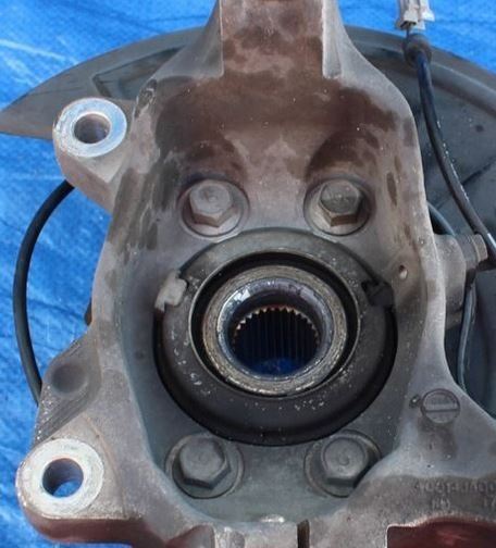

My front driver wheel bearing just went out at 85K.
I see there are 4 bolts holding the wheel bearing.
Just take out tire, remove axle nut, remove 4 wheel bearing bolts. Take out old wheel bearing, install new one and repeat steps.
Seems easy enough. What size are the 4 bolts?
