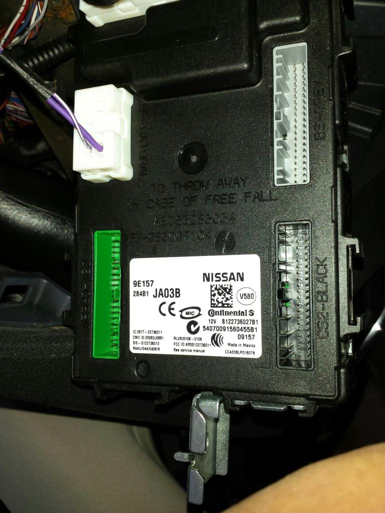

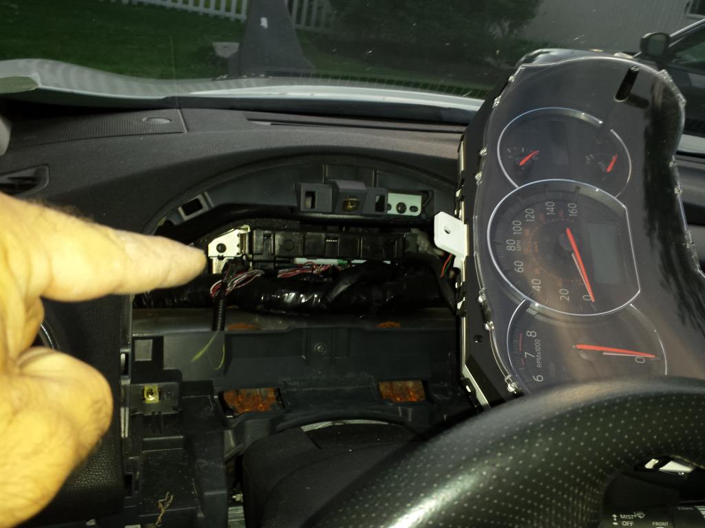

So I dug in deeper...found what was clicking when you lock and unlock. It lookalike a slim box that sits horizontally right behind the dashboard. Central control unit? Can someone confirm? The part numbers I am reading are 9E157 or JA03B

here are the pcitures of where it is...and the label...anyone can identify this as a Control Lock unit ( or whats the proper name for it?) and out of all the numbers which one is the part number?

I'm pretty sure that's your BCM (Basic Control Module). If it's going bad, Nissan's going to have to replace it. It controls a lot of things like your lights, door locks, power windows, electronic steering column, etc.

I took it out this morning.
From another forum, with similar problem, I got it to work intermittently ...by tapping on the relays inside
Which means will have to be replaced and this is only a bandaid.
From what I read , once replaced the keys would have to be reprogrammed to the new module.
I just want to confirm that's true, since it's little tedious to get the module in and out, which I could do. But programming might gave to be done by the dealer .

^Yes, the new BCM (Body Control Unit) will need "write configuration" using CONSULT III.
