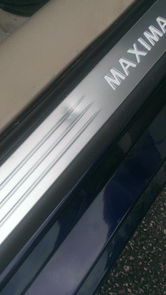

I am having the same problem with my 13. Took it in last Friday to have the part installed that the dealer ordered to fix the problem. The light came on all weekend every time my wife was sitting in the front seat. The dealer tech also took the time to dent the Maxima threshold plate and didn't bother to mention it. Looks like I'll have a few more trips back to the dealer.
Do you happen to have a copy of the work order for the part they installed? Also, has the new part resolved the issue? The dealership's system was currently down so they could not run the VIN on my vehicle to check for open recalls, but the service tech did mention that my particular '14 should have had it done so I should not worry.
