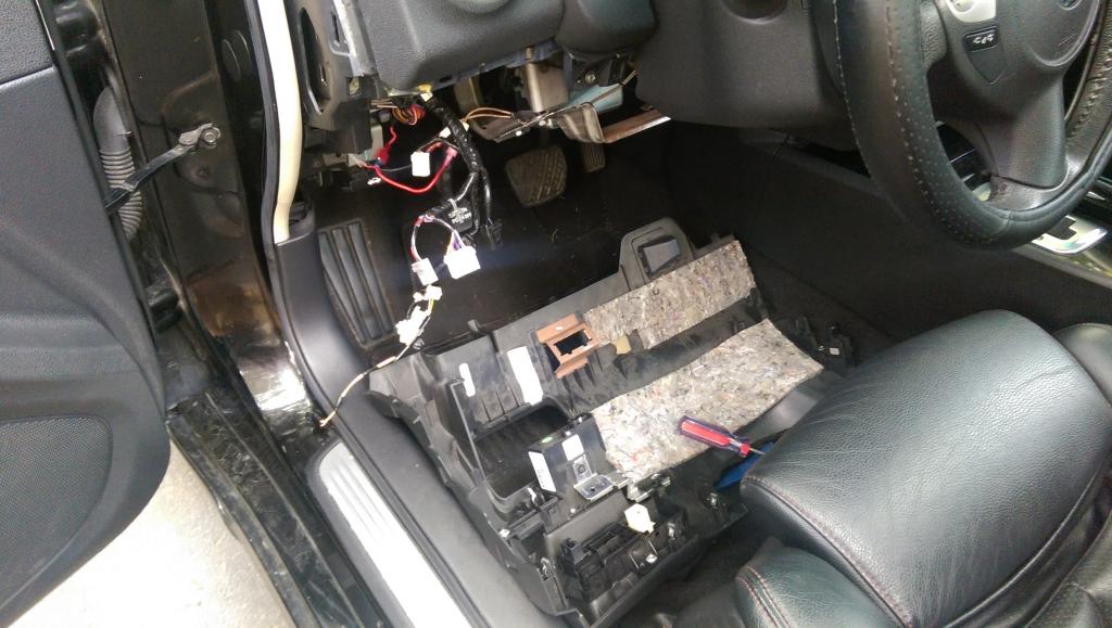

I started off by removing the bottom panel underneath the steering wheel. You simply pry off (GENTLY) the plastic panel on the side of the dash (you can do this with a panel tool or a screwdriver wrapped in a towel) and then remove the fuse panel door located next to the drivers left knee. From there you will see one screw attaching the bottom dash piece. Be careful with this screw as it is easy to drop it back behind the finisher plastic and carpet. Once that is removed just simply pull down on the dash piece and it should remove easily. You will see a set of plugs on the left, the odbII plug/floor light at the bottom middle, and one plug and a tube on the left (interior thermostat). Simply work through the plugs and remove them all. The interior thermostat tube simply pulls away. This installation is a lot easier with this piece removed. Some of the wire anchors are hard to remove but just wiggle them back and forth and try not to break them. They make wire organization a lot cleaner. Don't worry about some of the wires over to the left near the fuse box. Those are my power and ground for my tablet and radar.

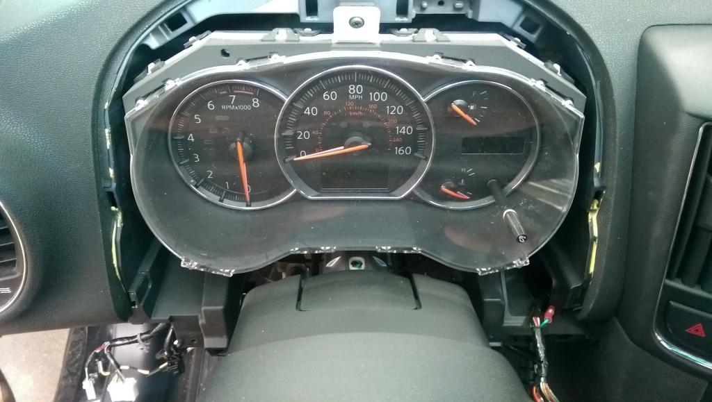

Then I went ahead and removed the instrument bezel panel by simply removing the two screws at the bottom and popping it out. Then I removed the instrument panel by removing the three screws. There is one plug on the back. The BCM is held in by two screws. These screws are in there tight but they will come loose. Just use a good headed Philips and take your time. Do not strip these screws. This was done to get to the push to start wire and the BCM door lock wire. I know some people have said the BCM door lock wire isn't needed but considering nobody has set this up yet, I figured I would get it done anyways.

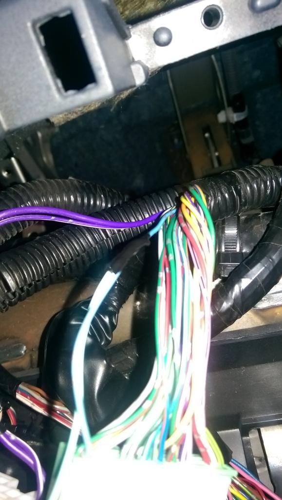

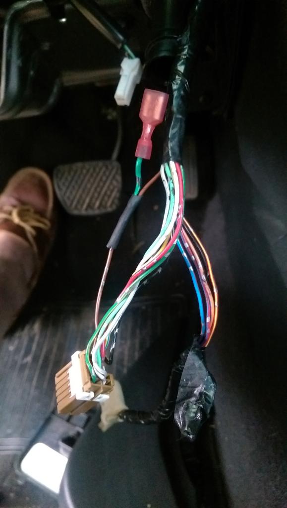

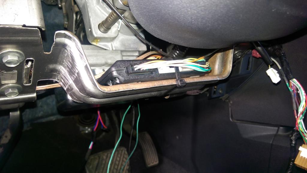

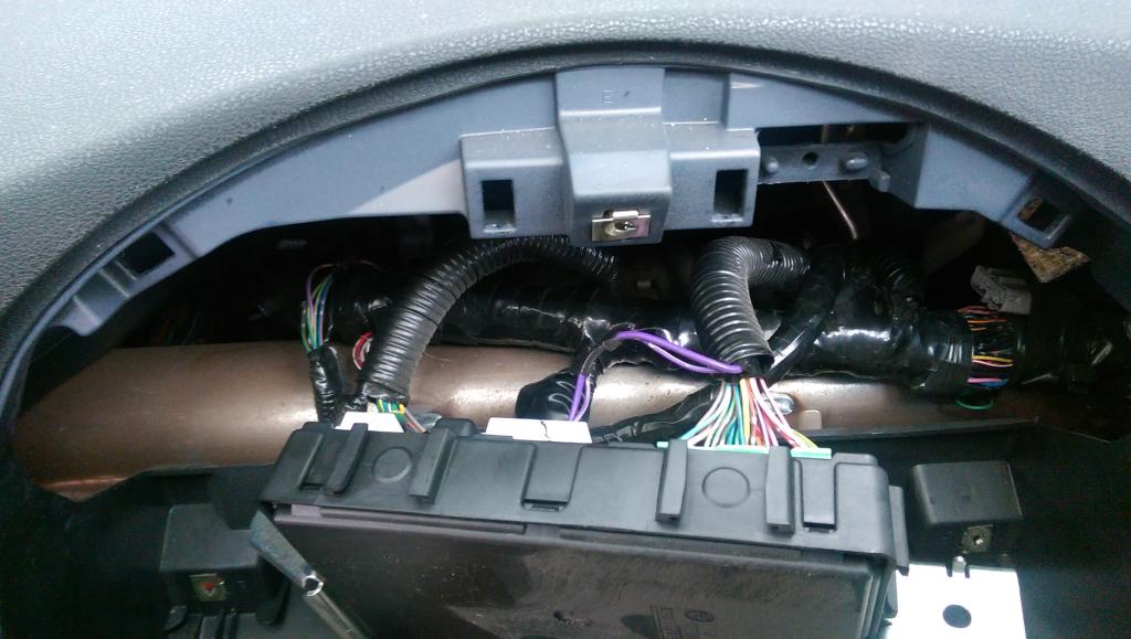

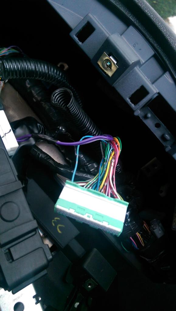

I removed just enough of the factory tape and wire loom to get the wires at each of the plugs. l soldered an extending wire to the brown wire on the push to start button and the light blue wire on the far left of the green BCM plug. I used liquid tape and then taped everything back up. I put quick connectors on the end of both of the wires so I could quickly remove the wires if needed.
The Push to Start wire from the harness is the Light Blue/White
The BCM Door Lock wire from the harness is the Light Blue/Black

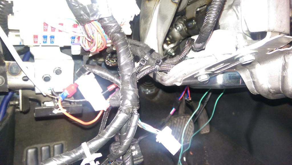

The next thing I did was lay out the wiring harness (THNISS3C) and clean it up. There are a lot of loose wires you won't need. You will only need the light blue/black and light blue/white wire. Zip tie everything and make it look nice. I take pride in keeping installations clean and tidy. Nothing worse than loose wires everywhere. I then mounted the DBALL2Pro unit with 3M high strength tape and some zip ties to the metal support bar under the steering wheel. I plugged everything in except for the white power plug. You will do this at a later step before programming the unit.

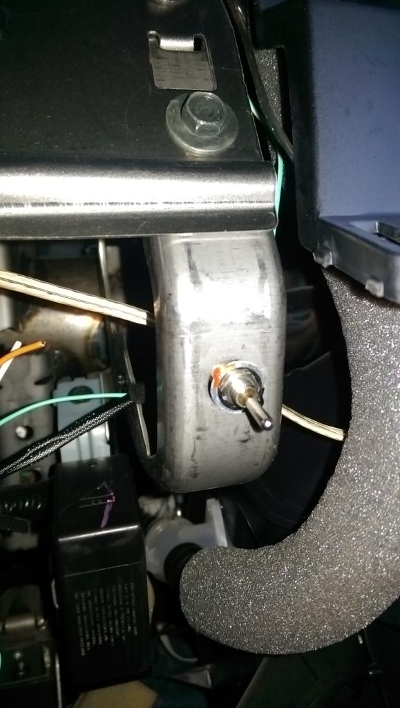

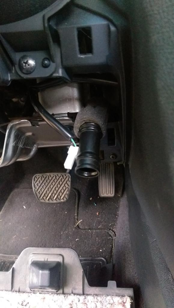

I mounted the override switch to the hole on the metal support tab next to the interior thermostat plug. You will see it if you crawl up under the dash. Clean up the wiring with zip ties. THIS HAS TO BE SET TO ON. IF SET TO OFF, YOUR PARKING LIGHTS WILL JUST FLASH 8 TIMES AND NOTHING WILL HAPPEN.

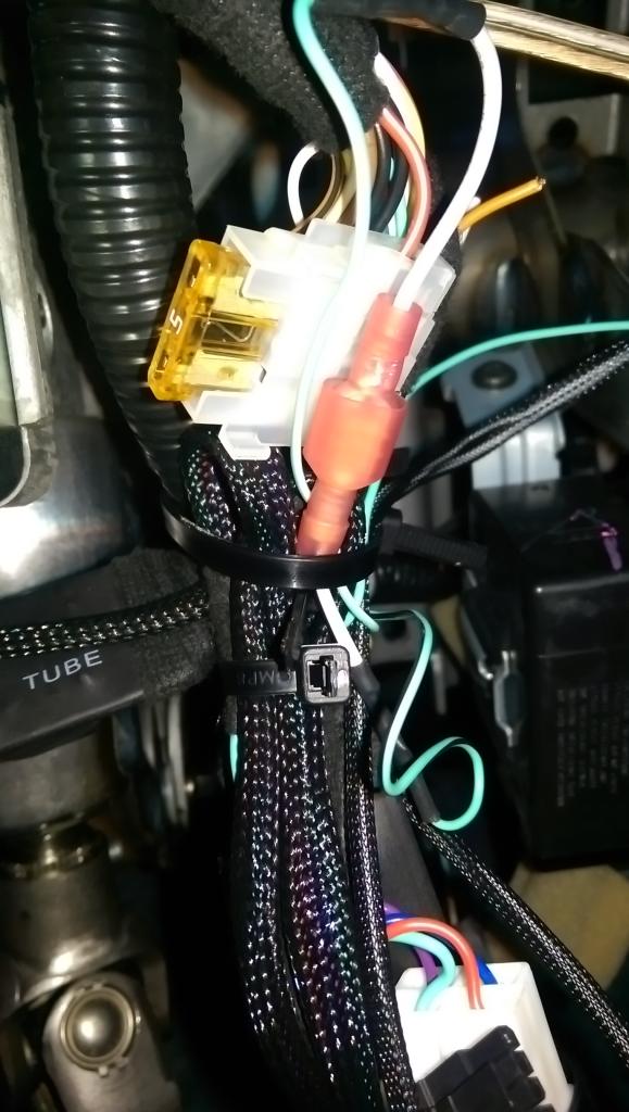

Plug everything from the harness into the car plugs and re install everything leaving access to the DBALL2Pro unit. Make sure you plug the brake plug into the one below with the wires on the outside, not the inside. I don't remember if it is the B-01 or B-02 because I was dumb enough to remove the stickers.

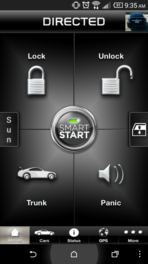

So I realized really quickly that the OEM keyfob has it's limitations. I wanted to be able to start my car from my office and gym so I decided to get the Directed Smart Start DSM200. I ended up getting a free year of service.
First off, Directed is one of the worst companies in terms of customer support. I bought my units at a discounted price online through and AUTHORIZED dealer and they still wouldn't help me with anything. They just kept saying go to an authorized dealer. It's my honest opinion there is a good amount of authorized dealers that don't know much more than I do and use the same research techniques I do.
All in all, I had to get the settings in my DBALL2Pro reset to accept D2D at the shop down the street. I'm a repeat customer so I just chucked the guy a 5 spot and it took him 10 min. Once I did that, I installed my Smart Start DSM200 (revision B), by mounting it to the BCM using zip ties. It needs to be as high as possible without metal interference. This location worked perfectly. Well here is where I ran into another problem. The 3 plug harness they give you isn't long enough unless the DSM200 is right next to the DBALL2Pro. So I had to extend the harness. Do not use the long harness with the brown 4 pin plug at the end. You have to use the white 4 pin plug attached to the 3 plug harness. You will see what I am talking about if you purchase the unit.
Once you do that make sure you plug in everything to the dball2pro except for white power plug (14 pin?). Make sure you connect the smart start into the white 4 Pin D2D port next to the 2 Pin port for the over ride switch. Also, make sure the gray wire from the smart start is grounded. YOU DO NOT NEED TO MAKE THE MAIN POWER CONNECTIONS (RED and BLACK). THE DSM200 WILL GET POWER FROM THE D2D port on the DBALL2PRO.
Plug in the main white power harness to the DBALL2Pro and everything should intialize. The light on the DSM200 will flash back and forth until it goes solid. Now it is time to activate. Directed told me an authorized dealer would have to do this but screw them I found a way around it talking to my tint guy (he used to do alarms).
Go to http://www.managesmartstart.com/install/login
Username: dei1
Passoword: dei1
Once you got through all the steps and download the app you should be good to go.

So apparently the smart start unit has a separate 5 pin plug that controls the aux that has to be set in direct wire mode. I would love to wire these to the window up and down and the sunroof crack and close. Would anybody have any idea how to do this or if I need a relay or not?

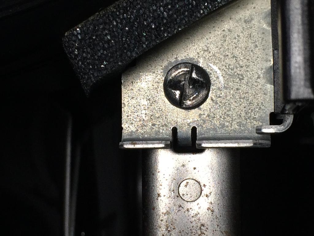

User JayD241 sent me this picture of his BCM screws. I don't know what year he has but I'm sure he can pitch in and say. I don't know if they make a screwdriver head for these type of screws but I see them all the time in bathroom stalls. I have a 2009 and they were standard phillips head screws but they were snug.
EDIT: For those of you with these screws, Dewalt makes a screwdriver bit set for said screws. You might be able to find an offbrand somewhere.

User JayD241 sent me this picture of his BCM screws. I don't know what year he has but I'm sure he can pitch in and say. I don't know if they make a screwdriver head for these type of screws but I see them all the time in bathroom stalls. I have a 2009 and they were standard phillips head screws but they were snug. Attachment 19369
