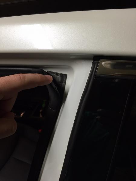

Update:
So I went this morning to pick up my car from the shop. The rep told me he took it for a drive this morning and believed the noise to be gone, confident they had found a solution. I was still skeptical. So off on a test drive I went before signing it back out. The noise was still there. Brought it back and told them what I had found.
They got the tech who worked on the moonroof to come out and he wanted to go for a ride in the back seat to see if he could locate the issue. It took us a half hour of test drives and playing with different stuff to finally figure it out.
Somebody had posted earlier in this thread about maybe the noise was from the weather seal on the door. That was a semi-solution. It turned out to be the corner of the weather seal at the top right of the frame, if you're looking at the driver's door from outside. Not the seal on the door, but the one on the chassis. The seal is glued all the way around except for this one intentional tab sticking up.
Apparently the dual panel roof models flex enough up top to make this corner ever so slightly loose, causing a popping sound upon impact of uneven terrain. He cut a piece of foam adhesive just big enough to stick on the frame behind the weather seal, under the tab, and make the fit between the frame and door tight. You can't even see the added material unless you purposely lift the tab away from the body.
It all but 100% fixed the issue. It's maybe 90+% quieter now, to the point that it's imperceptable, even over relatively large bumps. I got him to do the same thing to the passenger side and back doors just to be sure. Haven't heard a peep since. Thank God!

Placed some foam insulation at those locations but i still hear the creaking noise although it is better. Treated the rubber weather seals with Gummi Pfledge Stift and now there is no creaking sound. Not sure how long its going to last this time around as last time i used some silicone lubricant and that lasted only 2-3 weeks. In my case, the sound is definitely generated by the top of the rubber weather seal along the door rubbing against the frame. When i press against the top edge of the door (chrome trim) i can hear the rubbing/creaking noise but after the foam and Gummi Pfledge, there is no more noise.

I just wanted to thank you for posting this... along with the picture. I had the same noise on my '13 and it drove me nuts. A few pieces of foam in the same spot has quieted things down. Kudos for posting and updates to this.
