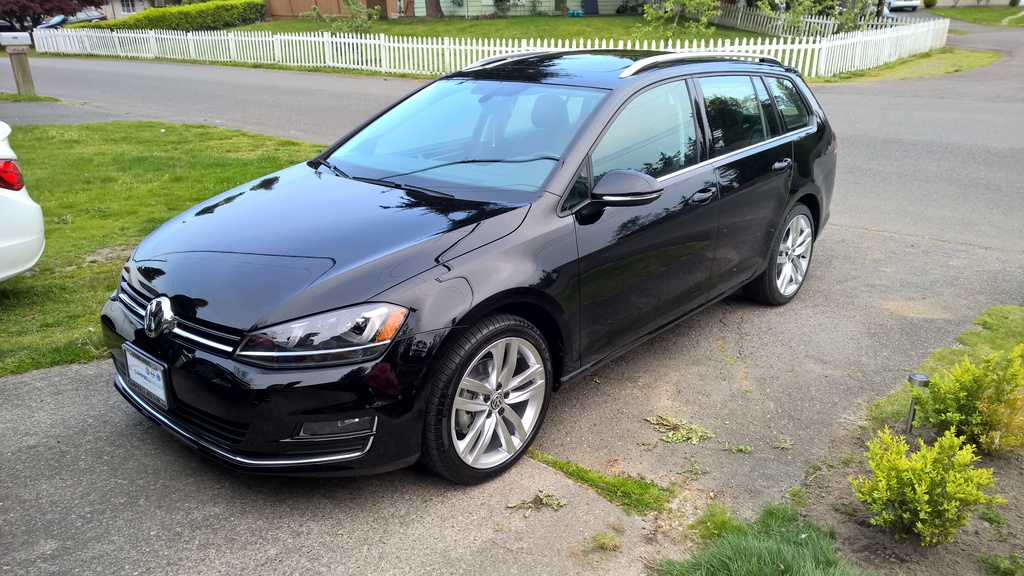

You could always get something with a DSG. I did to replace my wife's Mini (stay away from those).
